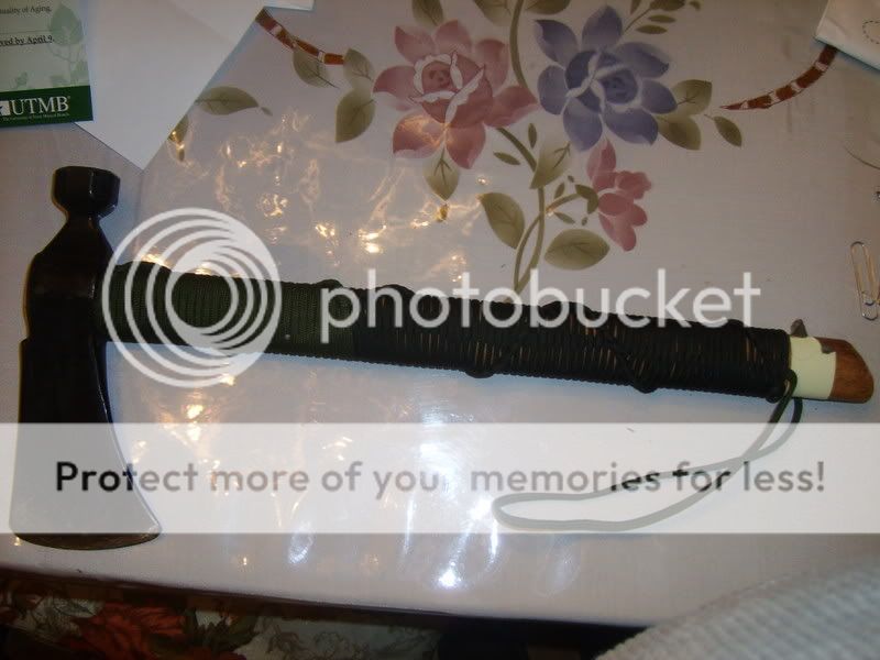

The way I did my CS Trail Hawk works but it aint pretty. Fist I cut the handle down to 12 1/2". Then I drilled a hole about 6' up from the bottom and drilled a lanyard hole near the end. I started at the upper hole by feeding the cord through the hole and tying an overhand knot in it. Then I wrapped down to the lanyard hole where I tied a second overhand knot in the cord to prevent it from slpping back. With the last of the cord i tied off a lanyard loop. done. BTW I painted the head od green before I started.
I stole the idea for this from someone here though I don't remember who.

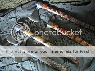

Here's mine.
Now that is a cord wrapped tomahawk!
I wanted to have some paracord available on my hawk just in case, but that is the mother of all cord wraps. How much cord is on that handle if you don't mind my asking, it looks ike it has about 12 feet or maybe a little more. I wrapped four feet around the head of mine.

Hatchetjack, I'm glad you posted those again, they're gorgeous.. The way you tricked 'em out is what finally convinced me to get one last summer. :thumbup: Mine is going through it's 3rd re-decorating, heh... where can I get some brass or silver tacks to dress it up more? Only thing is, no one warned me what a b***h it was gonna be to strip off that nasty black enamel off... it was worth it tho... a palm sander turned out to be just the ticket for that job.

Thanks for the kind words...in regards to tacks, I used brass furniture tacks from Ace Hardware. It helps to drill pilot holes as it's really tuff to hammer them into the hickory. Also, try paint stripper on your next Trailhawk to remove the finish.
