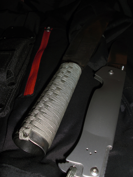

Here's how I did mine.
Nothing under the wrap, no problems with slippage. I looped vertically through the handle twice and then wrapped the handle from top to bottom, weaving in and out of the vertical strands. The end was terminated by tucking it under the bottom wrap, melting, and flattening so it wouldn't back out. If I ever need to use the cord I just have to snip the flared end.
42,
That looks awesome, could you post a drawing that would explain it to a 5-year-old? I am not quite getting how you did the weave.
The final step is to cut and melt the ends, flattening them out into a "button end" with a flat object so that they can't slide out of the wrap.

A nice thing about the wrap job I posted is that the ridge of the weave helps prevent rotation in the hand--one of the few shortcomings the Bushman has.
Awesome little tutorial there 42!
Thanks. It was something I had kind of just pulled out of thin air. I had heard people on here talking about how it was next to impossible to do, but I didn't have much to do that day and figured I'd just wing it to see what would happen. I'm pretty pleased with the results. :)
