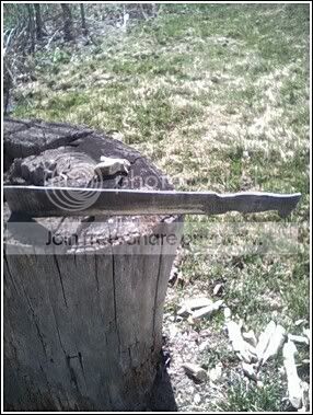

thanks for the help on this dan :) i thought i'd get back with it sooner.mete was kind enough to send a sawmill blade my way thanks again mete.here's a pic of the rough cut out. i put a convex edge on it and tested the balance/feel of it....this thing is sick, anything 1" or less green wood doesnt stand a chance i chopped through alot of sticks and branches and it just keeps cutting.
Now for the newbie ignorant question i was careful cutting it out and grinding not to get it hot could i just get away with a draw temper on the spine/tang.
