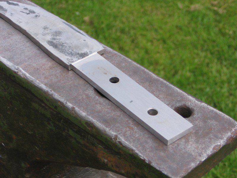

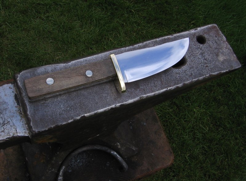

I can see why full tang knives are an issue with a hand forged blade - getting that tang flat enough for attaching scales is pretty damn tough. I dicked up the lanyard tube on the one side, along with a few other screw ups.
Beautiful knife! You should be damn proud.
Flattening the tang is a huge chore as you discovered.

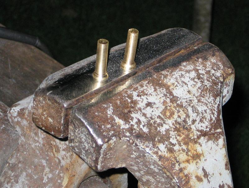

I made some brass rivets.
I need to put some shape on this handle like you did. It's a skinner/utility knife.
OK I made more of a real knife this time. I can see why full tang knives are an issue with a hand forged blade - getting that tang flat enough for attaching scales is pretty damn tough.
This is why I stick with stock removal for full tang knives. I end up spending more time trying to flatten the tang than I would just grinding the blade to shape. I think it's easier to forge blades from round stock than flat.
Thanks! That knife is coming along nicely too. I gotta get something besides coil springs to work with (unless I can get them off a train or something) - although I do like this little knife and I think I will make more of them. It's light as a feather and would probably make a nice EDC fixed blade.

How are you doing it? Because yours looks like frickin laser cut stock after you got done with it.
Hand filing. Checking both by eye and by calipers. I got it to +/- 1/100". With practice I found I could easily see 2/100" by eye without the use of the caliper. There was a time when machinists were trained to make precise parts with files alone. I'm not at that level but I'm learning.
