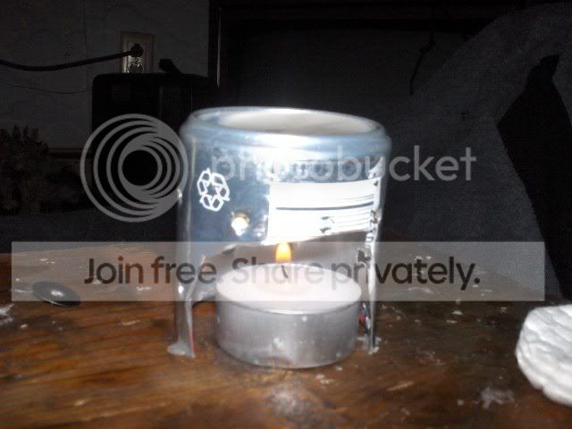

Next I needed something to melt my wax in so I made a burner.( yes that is a beer can)

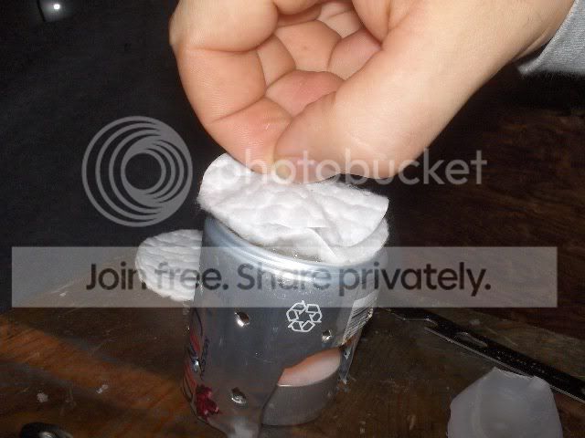

I stretched the cotton swabs apart some as they are 2 ply.once I got the wax boiling slightly I dipped one side in.

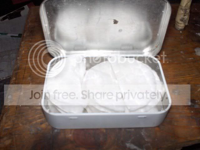

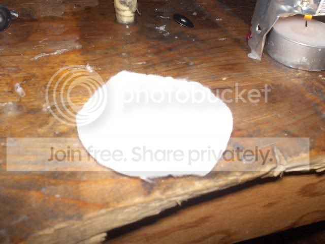

Then I set them down dry side down.this spreads the wax and still keeps some of the cotton "dry".They harden up kind of like little cotton chips.I cut them in half so I could cram more into my Altoids tin.

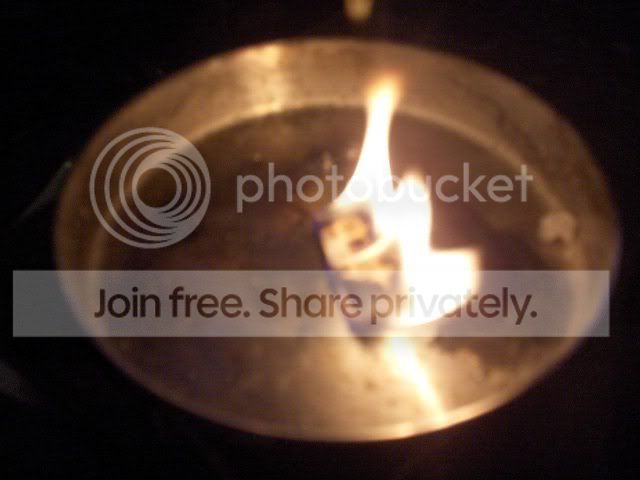

Now for the fun part,testing.I dug an old cooking pan out from my cook set in my pack and used it for a test site for my cotton chips.I put 1 slice in the pan and hit it with my ferro rod.it caught right away and gave off a hot and high flame.
This led to an unplesant though happy problem.I though I could just blow it out.WRONG.It was burning so well I couldn't get it to go out.So I'm running through my house with a flaming pan which got a lot of WTF!!! from my fokes.
I threw the whole works into the back yard and let it burn out.It took a while but it did.

hey, those are those round face swab pads right? HIGHLY absorbent......i imagine they would soak up a lot of wax........

Whoa your doing a no no with the flame to melt the wax as it Can Ignite ,use a double boiler{ pot with heated water and your wax in an other container resting in the heated water with the wax}

I agree with akabu - use a double boiler. It can be as simple as a can with water on a burner and a beer can sitting in the water (it will float a bit, depending on how much water is in the larger can). Place the wax in the beer can. This prevents the paraffin from realizing a temperature greater than 212 degrees F.
A quote from the internet:
Safety Tips for Wax Melting
Never have the wax in direct contact with the heat source. Wax is like grease, as it has a flash point. In general, wax has a flash point of 395 degrees. A flash point is the point where the wax is so hot that it burst into flames all by itself. So I say "IN GENERAL" the flash point of wax is 300 degrees. I tell everyone - if wax is smoking, it is too hot. The vapors produced are extremely flammable for any heat source like a stove. Use the double boiler. Don't melt it in a microwave. Our wax isn't made for this. I like my wax at 150 degrees for a variety of reasons.
Most paraffin waxes have a flash point around 395° F. When it reaches its flash point it may not smoke or bubble, it will usually just explode, splattering flaming wax in all directions. To avoid this catastrophe, always use the double boiling method to melt your wax. Water boils at 212° F, which is well below the flash point of any paraffin wax.
Yes, I said this twice in different ways, I want you to get the message. USE A DOUBLE BOILER! Not your crock pot, or your microwave, or in a pan on direct heat! Got it!
