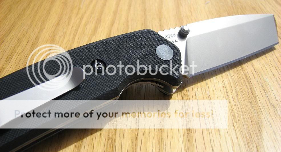

I do that with my Kershaw and Spyderco folders.

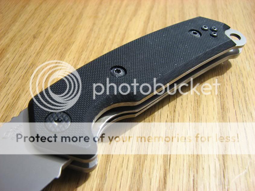

My best project thus far has got to be the Buck Bravo. Factory ergonomics were terrible.
I love the end result though.
Unfortunately the design if this liner lock is still terrible. They ground off 1/4 of the lock face on the blade to make it unlock more easily.:confused:
Out of the box the liner moved all the way across the tang, it took a bit of fiddling to get it to seat where it is.
Why in the world they would slap in a .05" liner to use as the lock when the handle already has two .075" liners is beyond me. Well, I know they did it because that's how they make all their locks but good grief if any knife could have used a thicker lock bar it's this one.
I guess scrapping the factory lock bar and fitting the handle liner as the locking liner would be next on the to do list for this knife.
Not forgetting to re-grind the lock face.
And replace the stop pin. Looks like there's room to fit a bolt in the blade and replace the thumbstuds and stop pin at the same time.

Where's the rest of that blade?
I don't know if your joking but that is how that knife is actually made. That would be a Buck Bravo and that missing tip is called a besh wedge. Haven't tried it, don't plan to and I don't find it aesthetically pleasing by a country mile. To each their own though.
