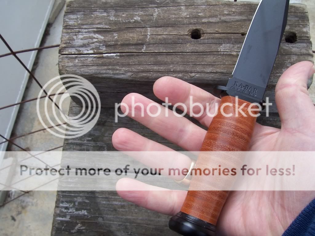

Couldn't resist the Leather Mark 1

What do you think of the handle?
Moose
I have smallish hands. I find the handle very comfortable. I'll have to do some work with it, but as a first impression, it feels like I could cut all day and not raise a blister.
If I were fussy that way, it might be a bit handle heavy. But I have good control of the blade and it makes me no nevermind.
I put it in the category of "almost too thick". But it fits in the hand well, and so far, LadyMoose hasn't gotten blisters from her kraton MKI, and she's put some time a whittlin' in with it.

My only gripe was the slick resin coating on the leather handle...
So...
1. Sanded it /w some emery-cloth that I use to prep copper pipe/fitting for solderin' (~200 grit) until the leather started to show thru.
2. Scoured it w/ a fine bristle stainless-steel wire brush, one way, in the direction of the washers, until the resin b/t the washers was cut thru.
3. Scoured it w/ a course bristle stainless-steel wire brush, one way, in the direction of the washers, until the groves b/t the washers started to "pop" and the resin was mostly gone from the surface... leaving a "brain-coral" finish.
4. Treated w/ hot "Sno-Seal" to protect and seal the leather.
The Sheath was also treated w/ Sno-Seal...
