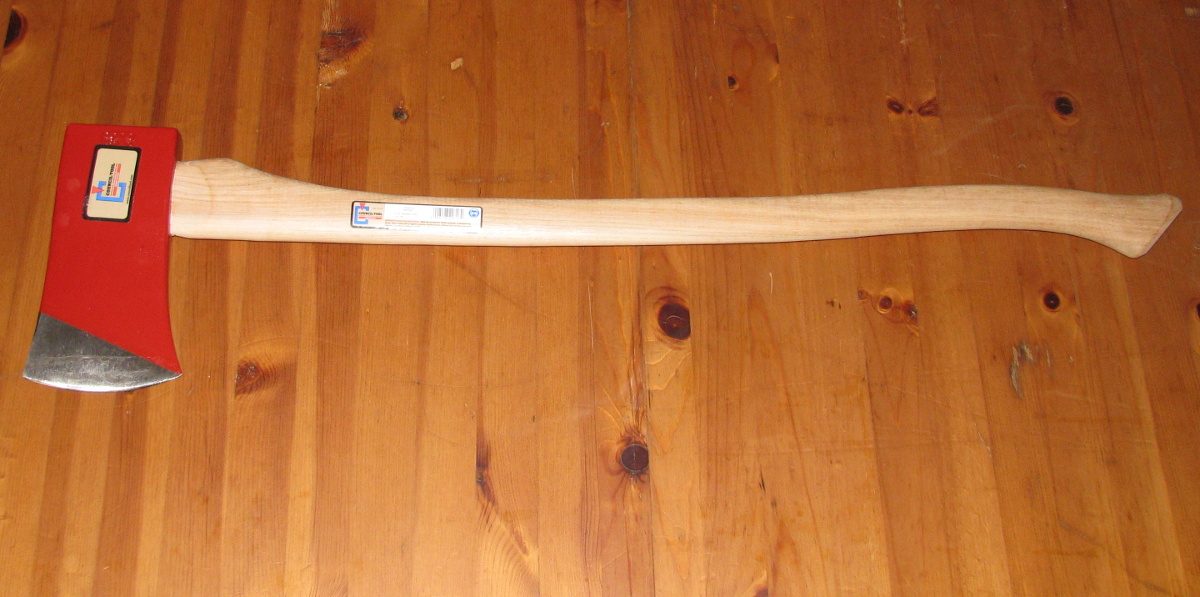

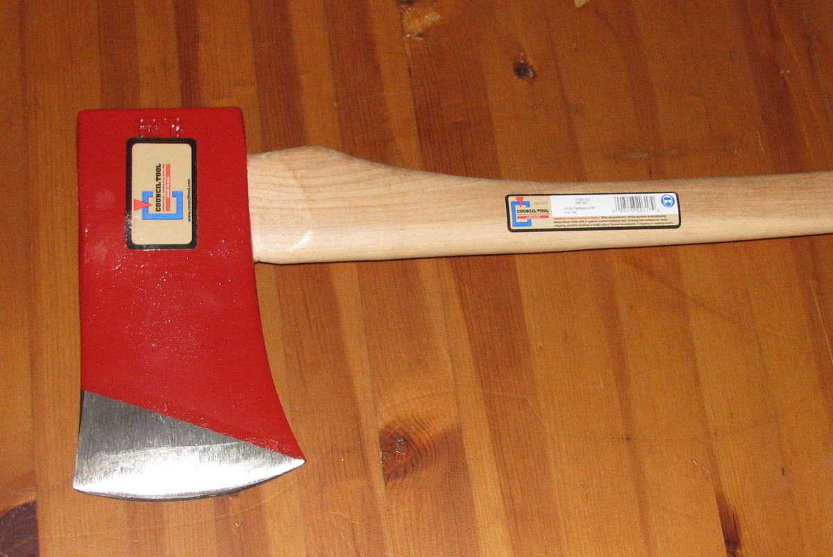

An update on this axe. I sent that warped axe back for a refund. Then I ordered a new one from Whiskey River. It arrived today. It has the features I liked in the warped-haft axe and came with a nice straight haft. Kudos to Whiskey River for stepping up and placing an order for these based on a client's need.
Now to the axe. The head is great. The haft isn't quite as slim as the last one but it ain't bad and it's straight! Overall length is 35-3/4". Axe head measures 8-1/2" x 4-3/4".

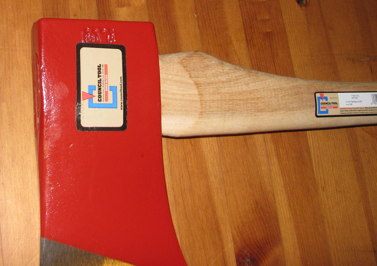

Stamp on the front side reads 'USA 18'. Backside has the standard Council Tools logo.

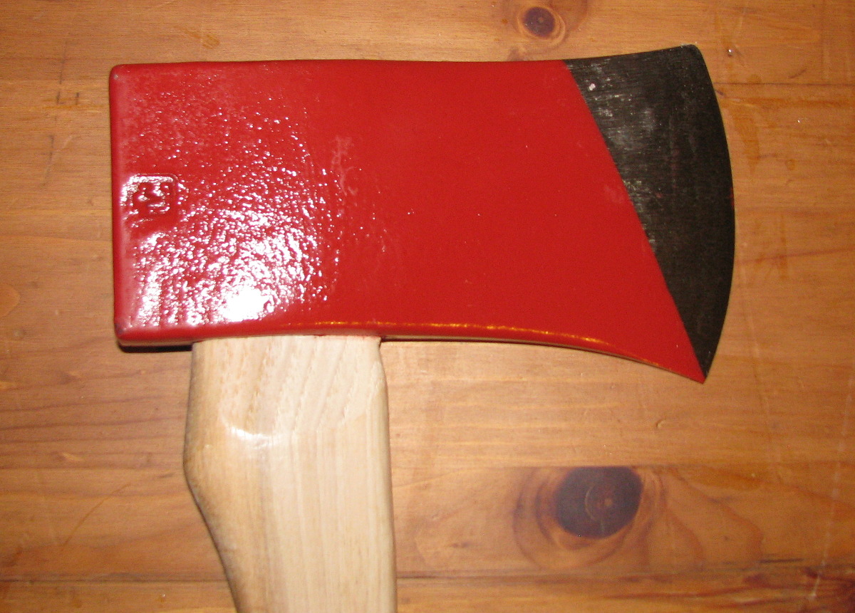

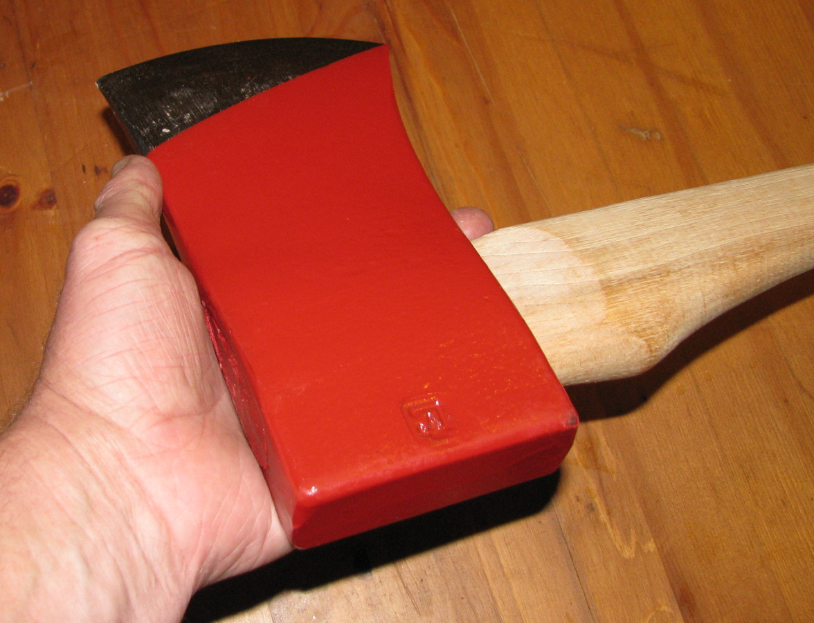

It has the convex cheeks of a classic American axe, something I'm very fond of. The bit/cheek geometry is really very good. I don't know of another maker currently producing axes with this geometry.
The profile is excellent, pretty much right to the FS axe gauge.
The edge needs only a light filing and honing to be a very good chopper and splitter. For it's intended purpose, fire axe/demolition, it is ready to roll from the factory.
I'm pleased with it. I plan to lightly file and hone the edge and give it a go as a chopper. But what I really wanted to test it at is as a splitter. I suspect it will blow away most if not all available splitting mauls on all but the biggest hardest pieces.

Didn't realize that stamp was a date code, mine says USA16. Props to CT for semi-serializing their tools.

This one certainly looks better than the previous and kudos to Whiskey River Trading for switching it out for you.
Your shot here is reminiscent of a larger rafting axe in profile from top down:
At six pounds I bet it will make an effective splitter - that is a big boy axe to swing very much at one time.
The handle might be somewhat thick but the head being that large might make it look thinner than it is.
For a new axe made in the USA, that is a score. Did it come in a box? I only ask because if they do then Whiskey River may have had a stack of them and filled the order without opening the box, you know, expecting a Council Tool to be in good form.
Can't wait to see it in action! :thumbsup:
Looks like Whiskey River received a box of 4 of these from Council and shipped one of them on to me in the box from Council. If I were Brandon I would have taken this opportunity to grab the pick of the litter for myself. If there was one better than this then he did very well. The haft is good solid hickory with good grain, 11 gr/inch and maybe 20° off vertical.
