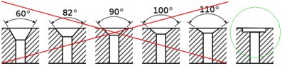

Hi, can anyone give me tips on how to countersink screws in G10/Micarta. The counterskink bits available at my local hardware store countersink but at an angle/bevel. Looking for something or someway to create a countersinked screwhole which is terraced or stepped down flat instead of a tapered countersink hole.
In this illustration, the screws are tapered or beveled. This is what I DO NOT want to do, but have the bevel or countersink 90 degrees to the flat surface. The one in the gree circle is what I would like to achieve.
Any and all help is appreciated.

Drill the larger hole first to the correct depth of the screw head, then drill the rest of the way through for the screw.
I countersink holes in wood scales (for Chicago bolts) this way, but I use standard drill bits in my drill press. Actually I drill the smaller hole first then use the larger bit to create the countersinks. The bottoms of the countersinks are not flat, they are tapered a little bit, but it doesn't matter. Plus for putting scales on fixed blades everything is epoxied so it all ends up very solid. I think countersinks are very touchy, you need to be very careful with the depth. I go slowly and use the stop on my drill press for trial and error so I don't drill too deep.
Yes, thats the way I counter sink some of mine on G10 as well. But he's doing them the manner as a blind cutlers bolt is done. Which is ok too. If your not experience on counter sinking go slow and be careful working G10. I don't care to work with it any more. Wear respirator and eye goggles, tightly. DM

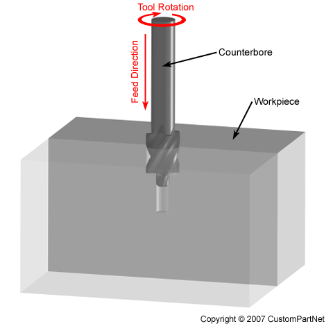

Actually, there is a specific tool for this application - it is called a "counterbore bit". It is like a countersink bit, but it will drill a clean, square bottomed shoulder on the outer hole. The Counterbore bits have a guide, which is smaller than the counterbore and helps you keep the holes lined up and concentric. Do some searching at your usual tool sites and you'll find lots of different types - and unless you go for a fancy carbide bit, they are relatively inexpensive for regular HSS (which is fine for G10 and micarta).
The other option is to buy one of the "stepped drill bits from some of the knife supply stores. These are regular drill bits which have been trimmed down on the last half-inch, so that you get a nice flat-bottomed counterbore hole. Relatively expensive though...
