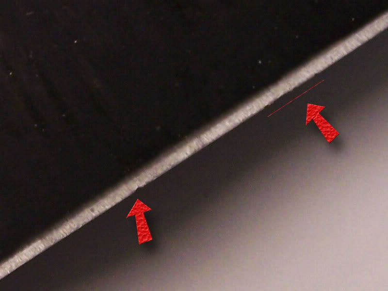

Couple edge damage pics
I really like the cutting performance offered by the thin & narrow angled edge.
Since the damage is constrained to a small fraction of the edge bevel the entire edge bevel doesn't need to be made more obtuse. A decent starting point is to grind the edge at the existing angle until the damage has been cut in half at the deepest point and then increase the bevel a few degrees to remove the remaining damage. Since this additional bevel is only a small fraction of the main bevel width it should have a corrospondingly small reduction in the cutting ability but can still induce a large change in the durability. It also only has to be done in the spots where you are likely to use for heavy impacts.

Here are the pics (bad ones) of the damage and the edge thickness.
Damage is less bad than I thought, and there is no sign of damage from the portion of the edge I used to chop the banding. The nicked spots are from the first cut using improper technique.
Off hand, I can't put my finger on it, but my gut reaction is that increasing the edge angle much more, even on just a narrow width of the edge bevel, would decrease my cutting ability more than I like. It's been a while since I've really compared it though. Since I'm using a very coarse edge for draw cutting, the micro teeth may be shorter or something. But there have been times in the past when I used a microbevel up to 30 degrees per side (mostly when the coons discover the silo at the quonset- then most of my cuts will be on concrete) but I generally don't go that high now. I can't point to a specific instance where I noticed a problem with this steeper edge, but over time I've come to like the shallower angle.
I do use a steeper angle on the last 3 inches of the tip for this reason though. I found that since I made the knife, it has lost 1/4" of length, but only 1/8" of width, indicating the tip area sees more abuse and therefore needs beefing up more than the belly.
I probably would do this (roll on a steeper bevel at the very edge) if this level of damage really bothered me. But really, if I can sharpen it out in 5 or 10 minutes, it ain't a huge deal. Like I said in my first post, I was posting these pictures more to share for discussion rather than in disgust. Sure, I'd like better, which is why I'm exploring other materials, but the edge I'm using now has no trouble with my primary targets. It's always those accidental impacts on hard stuff that cause the problems, but I can't let them totally dictate things either.

thanks for the pictures. That edge certainly does look thinner than the ones I saw at the show, but it's still kinda hard to tell from pictures like this when thousandths of an inch can make such a big difference. Really it doesn't look bad at all though.
A trick I've found useful for measuring edge thickness is to press the edge into a piece of wax. Press it until the wax extends halfway up the edge bevel, and make another impression to the full depth of the edge bevel to get an idea of the geometry. Then you can compare the width of the notches left in the wax to something of known thickness if you don't have a calipers. I've always got mechanical drafting pencils layin' around that take leads .5 and .3 mm thick to compare with.
