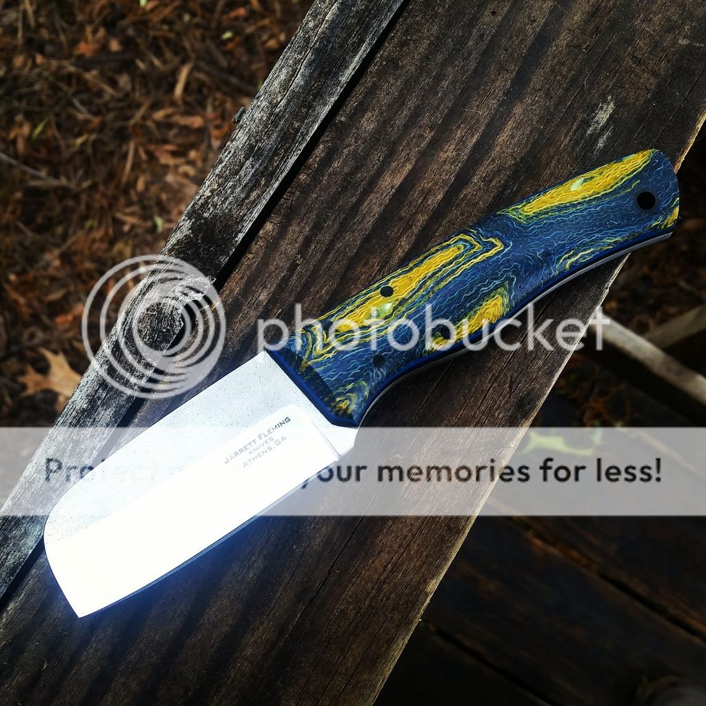

The first one is a new model. I haven't decided on a name yet, but it came about after someone requested a small cleaver blade with a full sized handle.
This one is wearing some of Dylan's starry night burlap.

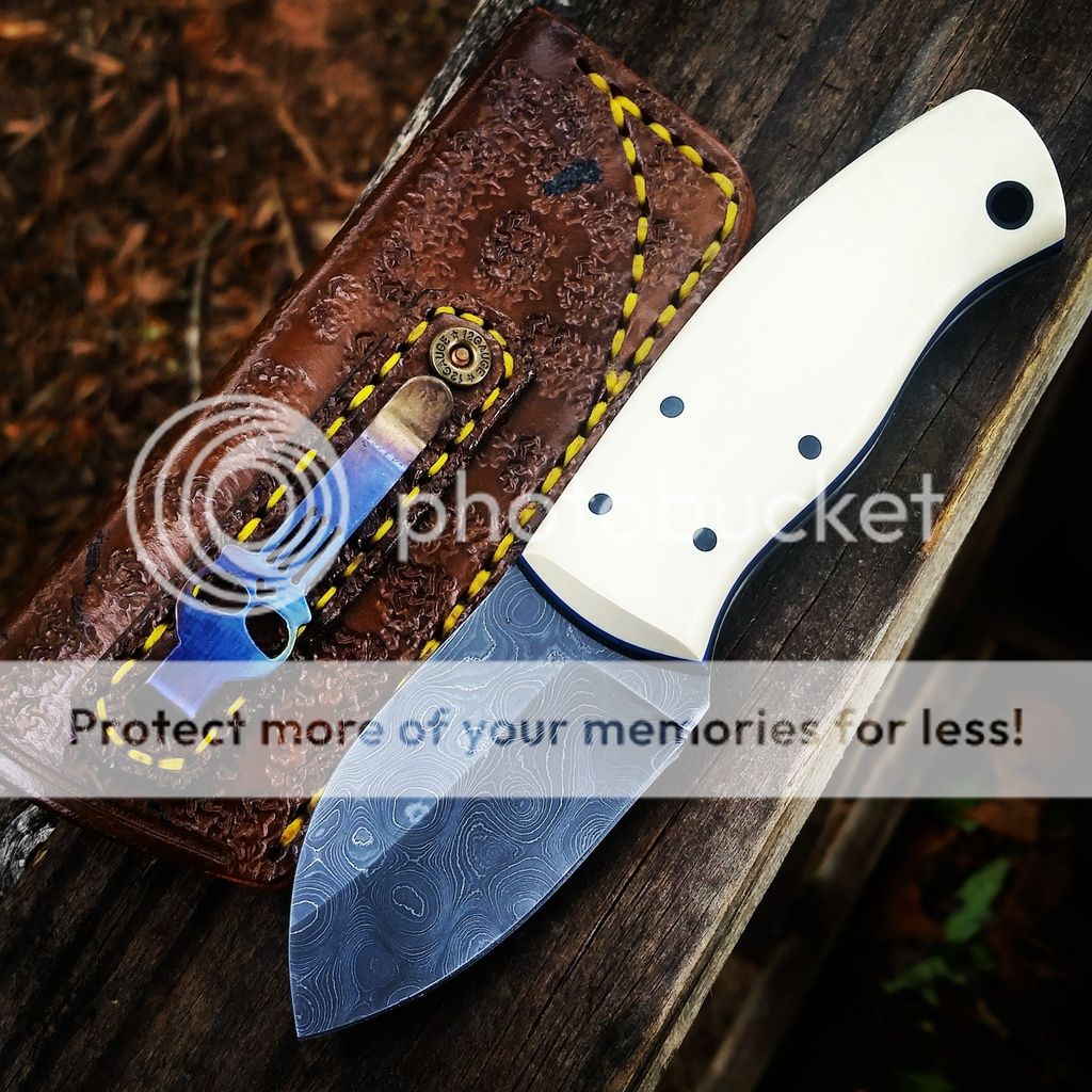

The second knife is a damscus itty bitty. I had Bud make me an ISP sheath for an itty bitty a while back and finally had the time to make a knife for it. The handles are made from some old international paper micarta.

That's a sweet IB.......what's the composition of the damascus you're using ? Hardness rating ?
Peter
Peter this is alabama damascus that I bought a while back. The composition is (4) layers 5160, (3) layers 203E, (3) layers 52100, (3) layers 15N20 folded 5 times for 416 layer damascus.
Following the ht data provided by the manufacturer the hardness should be 58 RHC.
