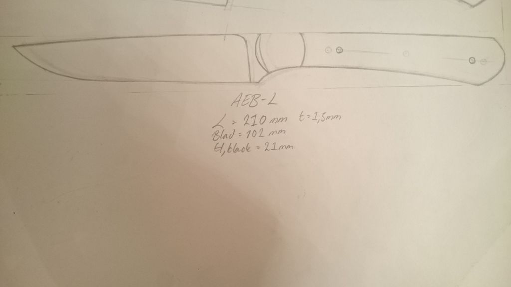

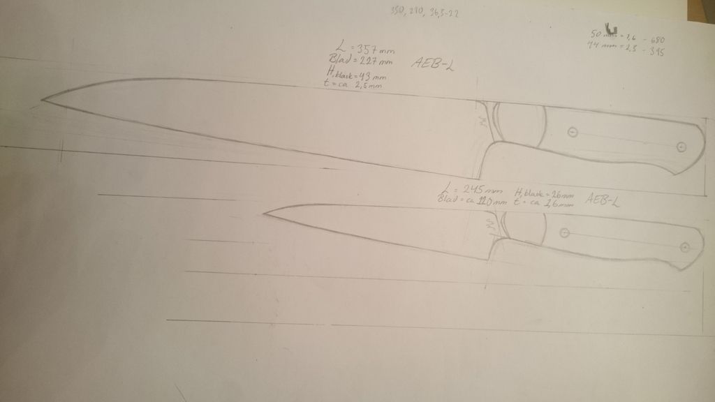

Hello,
I've been away from my grinder for a semester of studies, so I have been unable to make any knives.. But I'll be going home for a week and I'm planning on doing some grinding :cool:
Here's a few idéas I'll be working on, though I doubt I will be able to finish anything, but at least they will be ready for HT next time I'm back home.
These drawings were done in a hurry, so I might change stuff as go about making them. Scales will be micarta and the bolsters 416 SS and Stainless Corby rivets.
I will be making a prototype out of some aluminium to get a feel for this steak knife, subject to change!:D
I will be making an EDC fixed blade as well :thumbup::thumbup:
Any thought and comments are always welcome!
Kind regards!

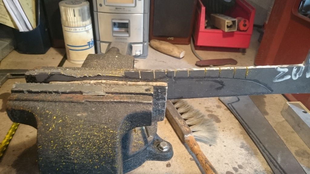

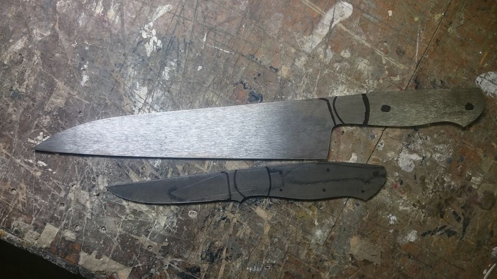

Made some progress today, the large kitchen knife has been profiled as well as my EDC, which is made out of some CPM 154 steel I had left over from another project. Super happy with how both of them feel in the hand, I think they will turn out great!:cool:
I use a hacksaw and files, as well as the belt grinder to do the profiling. :livid:
