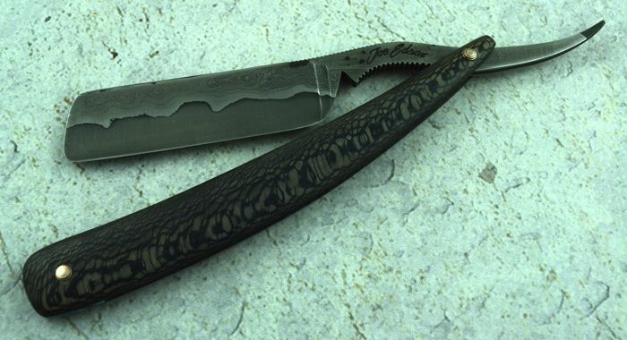

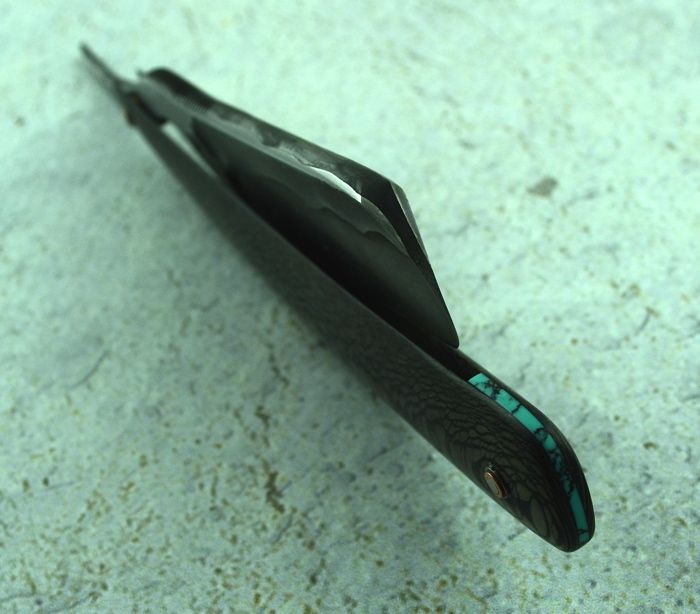

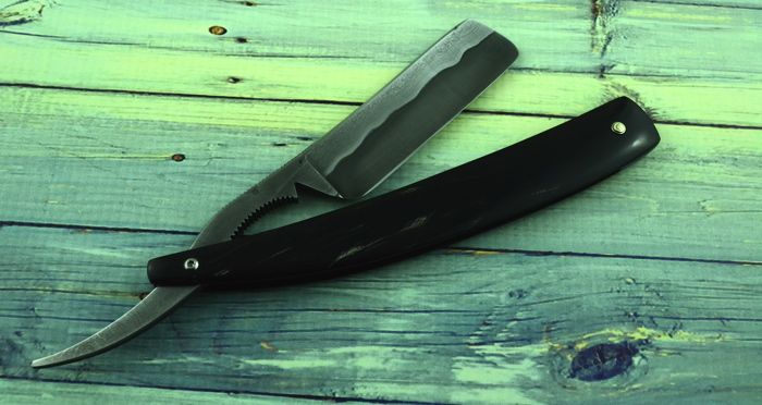

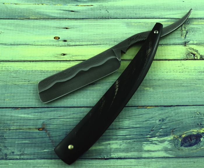

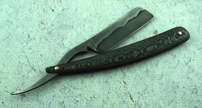

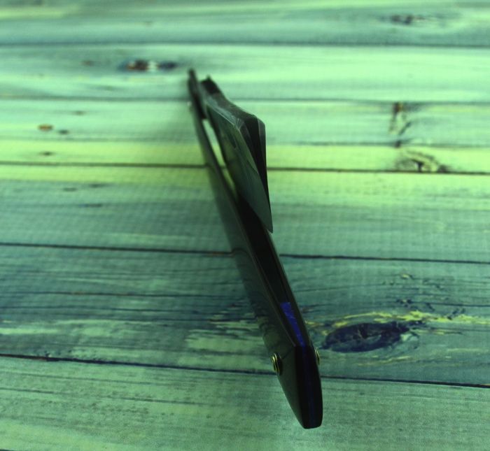

These are a couple straights I just finished using some San Mai (W2 clad in A203E) I got from Leethal Cutlery here awhile back.
These are my "Odin's Edge" model named as such because they are my take on a very popular Swedish Heljestrand model from the late 1800s/early 1900s.
Both are around 7/8" wide with 2.75" cutting edges and about a 1/2 -3/4 hollow grind. Spine widths around 0.225".
Thanks for looking!
Scales on this one are black snakeskin sycamore from burlsource:
Scales on this one are streaked buffalo horn per customers request:
I just love seeing the grinds on straight razors, I'm sure if I tried the blade would look like Swiss cheese in no time flat! Very nice looking blades!
