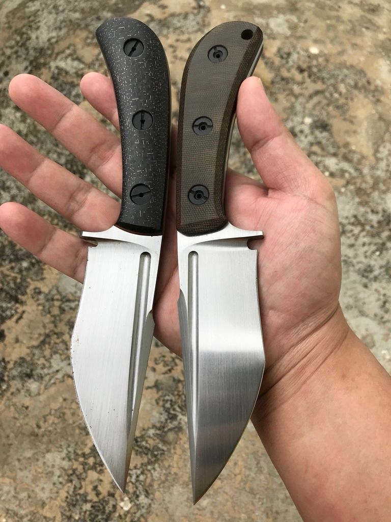

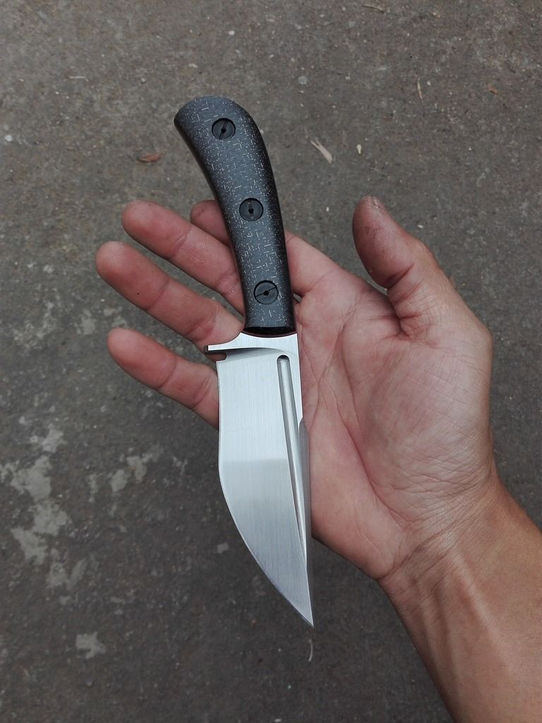

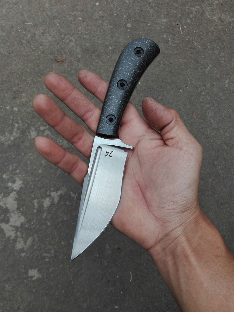

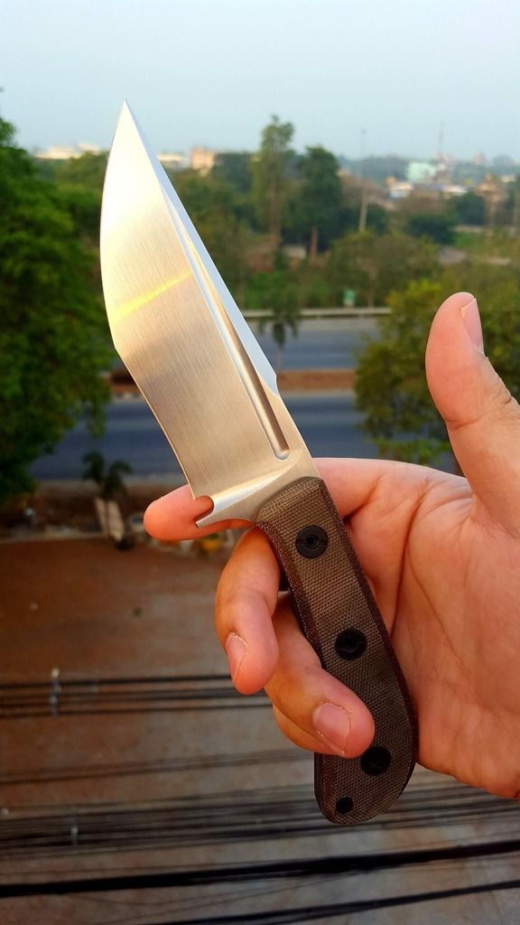

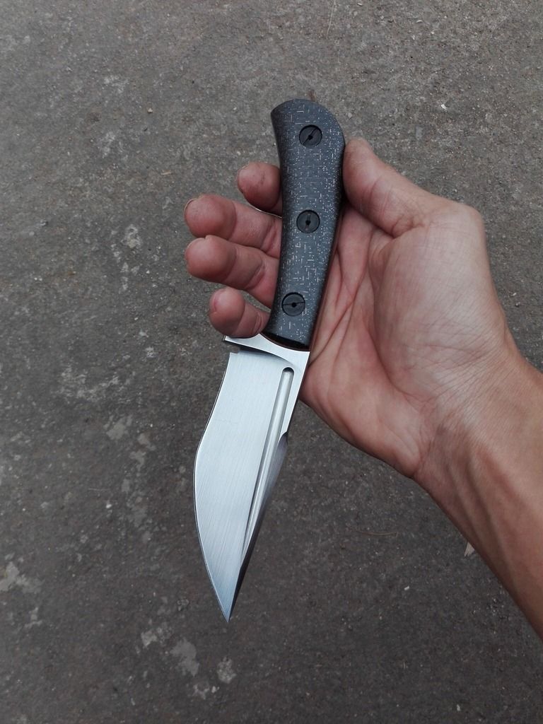

CPM-3V 4" Tactical Fighter from Thailand !!
Mar 26, 2012
2,301
The knife was made by my friend, SongRit Mawan. He is arguably one of the most talent maker here.
This was inspired from Winkler's belt knife but the overall shape has been modified significantly.
Overall: 9"
Blade: 4"
The blade got distal tapering to the tip with taper tang.
Micarta handle with black G10 spacer.
Steel is 0.275" CPM-3V
I shipped these knives to Peters for HT with the latest low tempering protocol to 61HRC.
Thanks for looking!
