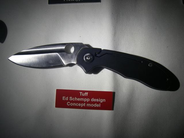

Spyderco Tuff is the knife that comes to mind immediately and is one I don't get—titanium framelock (weak mechanism) and 4 mm thick 3V blade with a 3.00" cutting edge. I had the same thoughts on the steel choice.

Nothing about the Tuff strikes me as weak including the lock. It's all relative though .Weak compared to what? I'd guess the knife would give somewhere else than the lock under most sorts of test. Anything can be broken though and yes, I've seen Cold Steel videos. I get by with much less strong locks and knives on a daily basis and have never broken a knife or lock in almost 50 years of knife use. In fact I carried non locking knives for a few decades without any problems.
From what I remember that design came about as a request from people on the forums and Sal gave the task of designing it to Ed Schempp. He did a pretty good job of giving the folks what they wanted. Some agreed with you about the use of 3V in a folder, some didn't. I really like 3V personally including in folders. I've often thought if I had to pick only one steel I would get one from this class 3V through Cruwear on up to 4V, maybe CPM M4. Excellent wear resistance and toughness with good edge stability and ease of sharpening. I'm glad I don't have to pick just one though.

I don't particularly like the tuff design but I'm not a fan of many Schempp designs. Don't know why. They seem completely off balanced.

A titanium framelock is weak in general compared to several other well-known types of locks. I remember some people having issues with their Tuff after 'hard use', in one case a failure after some light chopping of small branches. Anyways, my point is that you shouldn't need the toughness of 3V for anything you ought to be doing with a ti framelock with a 3" cutting edge, and that makes 3V an odd choice of steel. Note that the Tuff prototype also at one point had an integral compression lock.
"Liner and frame locks are a long leaf spring and they tend to collaspe under pressure. Compression locks and lock backs are much stronger."
-Ed Schempp
