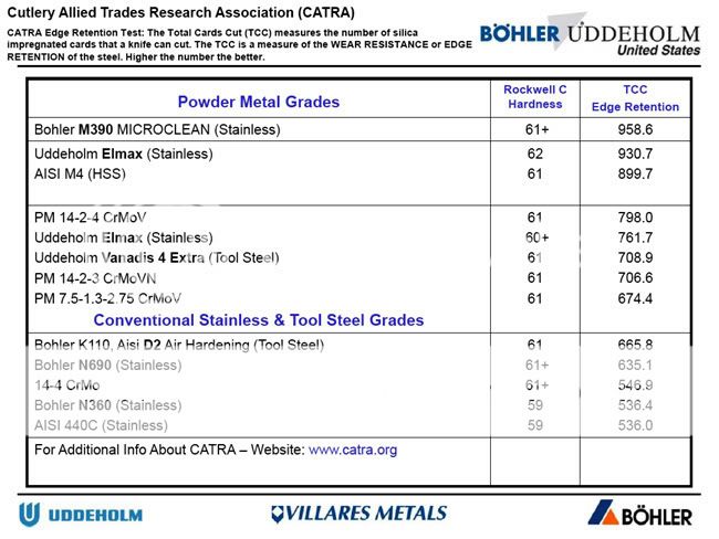

Bohler has their catra numbers chart that lists 3V (PM 7.5-1.3-2.75 CrMoV) rating on it. The numbers put it slightly ahead of D2 at 61 rc, but below steels such as S30V, S35VN, Elmax, M4, and M390. How big these differences are is beyond my knowledge. CATRA may not be the end all of tests, but it is one aspect to look at. From this data, it looks like it exhibits a good balance of above average edge retention and the toughness it is said to have. Apparently, if you want to go a step further in the wear resistance direction, CPM-4V is available, which still retains above average toughness. It just doesn't have the god like 3V toughness numbers according to the Crucible sheets. You have to give something up to get another it seems.
