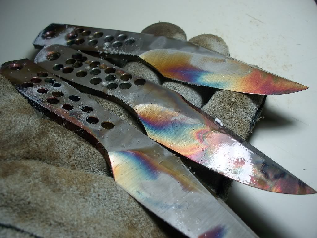

I am tempering these as I write this, here they are after quench.
For heat treat I plate quenched with 1" thick Aluminum plates after a 30 minute soak at 1950 F, once they were cool I took them directly into sub zero (dry ice/denatured alcohol) before temper. After this first temper they will get another sub zero cycle then one more temper. I should get a point or two extra hardness with no sacrifice in toughness with this procedure, CPM-3V is some great steel!

Dan do you think a triple quench would be good? how do you plan to finish the surface as 3V could pit instead of rust.

Thanks! I don't think a triple quench would work with CPM-3V but I have to say it was a somewhat involved heat treat with the sub zero and all. I'll be doing a combination of hand and belt finishing on these, they should be somewhat pit and rust resistant that way for a carbon steel. The shape is a new favorite of mine, look out for more in the future.
