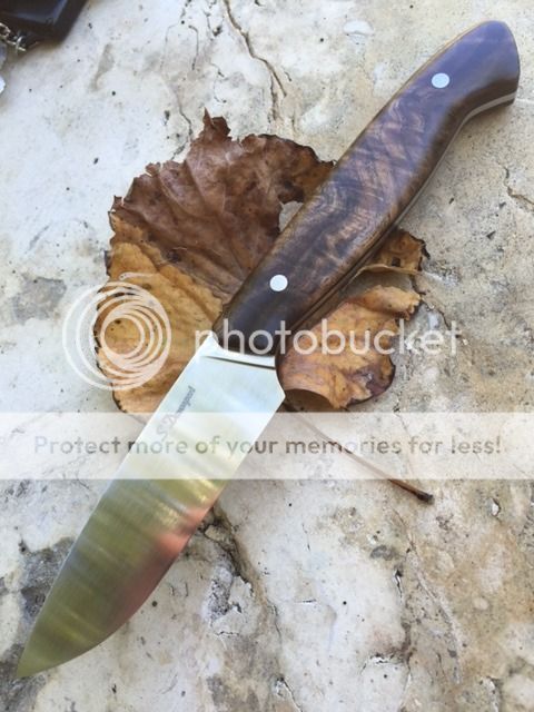

Figured I'd give CPM M4 a go around this year. This was from .106" bar stock, supplied by Chuck Bybee, and the heat treat done by Peter's Heat Treating to 64HRC. Custom HT: no snap temper, straight to the LN, and 3 low temp temper cycles. (thank you Brad) 0.008" before sharpening, full flat grind. Stabilized Walnut Burl from Chuck Bybee, black G10 liners, SS corby bolts. Can't wait to sharpen it tonight, I'll probably do the "usual" 15°DPS edge at 1 micron. Feel free to comment, critique, or place an order! Thank you for stopping by.

Another beauty, Stuart, I sure like mine. Been using it in the kitchen to get used to it for deer season. The CPM-M4 is terrific.
The new one has a little less drop at the tip than mine does- I like both! And, you changed your blade marking.

Stuart, by 15dps do you mean 30° included? I have never tryied M4, do you think it won't stand lower angles?

Thank you, kind gents! Stefano....yes, sir. 30° included. Forgot to mention that it is at 64HRC....post edited to reflect that. I actually think M4 WILL stand lower angles....for the type of work that knife will see. Due to the CPM process, it's fairly fine grained steel.
I am always looking at opinions on how low an edge can be taken for a given steel/given application. Obviously...a knife like the one above isn't a camp knife, mainly a meat slicing machine, and the edge will not be torqued much. So if someone says, "I use M4 at 64HRC on deer and mine is at 20° inclusive...no issues", my sharpening stones will be drug out again!
Sharpened it last night, and what fun that was! To establish a quick bevel, I had a used 60 grit belt that I cut and laid out. I did not want to apex with that belt, just establish the bevel. Moved to a 400 Naniwa Superstone. Very strange....the metal swarf was clearly visible, but I felt like I was getting NO where with that stone. Kept my eye on how much light was being reflected by the edge, seemed like no change even after some moderate pressure on the stone. Moved to the XC DMT....and that went somewhat faster....almost apexing with the DMT. Back to the 400 Naniwa...apexed....and wow what an edge. Moved up to Naniwa 2000 Green Brick, and that stone took out all the "bite" the edge had. Moved up to 4000 King, and it felt like I was dulling the apex, those two stones maybe too soft? Not sure what was going on. Moved back to the 400 superstone and left it there, finishing with a few light edge trailing passes. VERY aggressive edge.
Anybody with thoughts on CPM M4 performance, or sharpening tips, I'm all ears.
