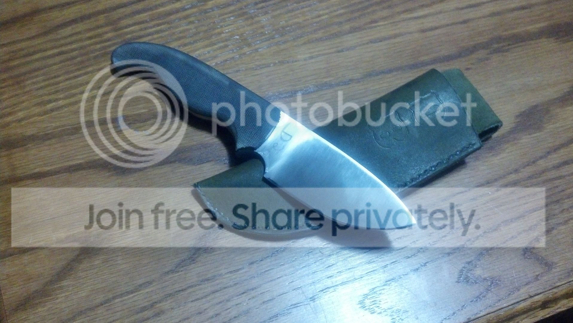

Hello Bladeforums! Im back with a paid membership now and life is slowly coming together in our new house and a healthy 6 month old baby. Ive been dreaming and grinding away and ordering steel and am having some blanks waterjet cut, which will be sent to Peters heat treat for once theyre done. I currently have G-10 and Micarta handle materials ill be attaching, and duracoating some. This post is a prototype intro to some models that will be coming In CPM-M4 high speed steel, and ive had made a couple out of other tool steel for testing i can share. Kydex or leather sheaths.
This is the nightstalker, after the worlds deadliest scorpion. A useful utility knife with a full flat grind. Will be selling around $225.

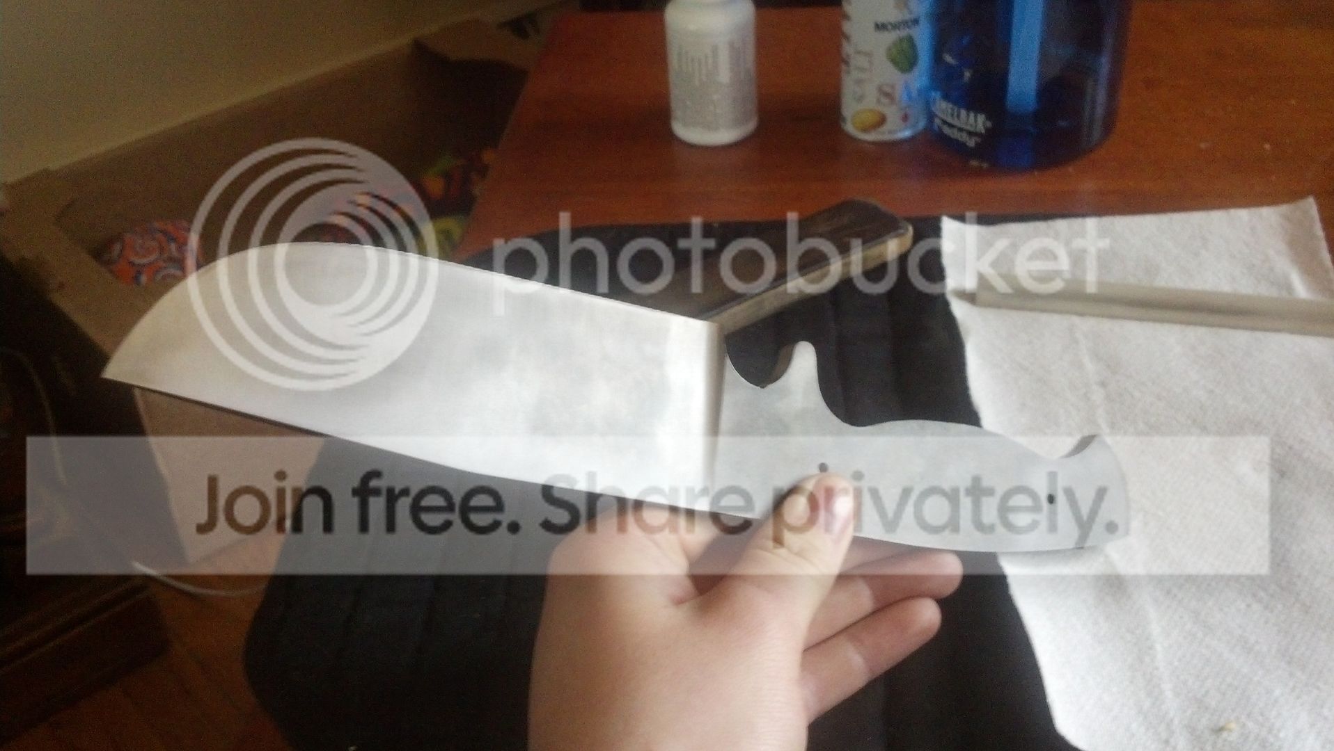

Next up at a stout 5/16ths thick and 2 inches wide with a 7 inch blade is the destroyer. As ive enjoyed my adventures with my big knives i needed to make one. this bead blasted one is at peters right now, ill post pics when done. Due to the expense of dealing with larger material, will be selling for $275-325 range
Lastly the 3/16ths inch thick Mini-Kukri has a 3/16ths thickness and about 6 inch blade length. recurves are hard to flat grind evenly but im going to try.

Hey everyone, feedback welcome. these are not one of a kind work of art pieces, im trying for consistency and establishing a "model" and hopefully producing many. I Got my chem etch stencils in today so ive been playing with that
