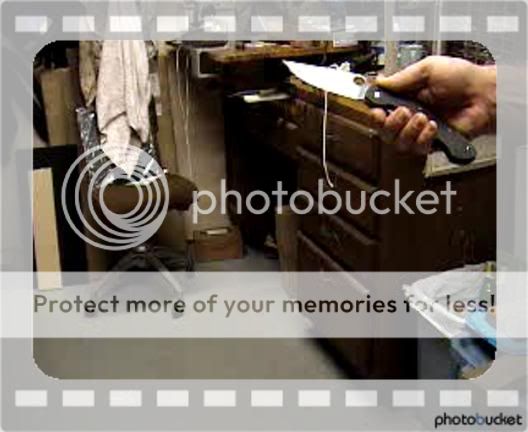

To offer a different opinion, my thinned and polished (by hand so convexed) S30v mili is one of my favorite users. I think S30V performs great when polished. I appreciate how easy it is to keep very sharp. Here it is cutting a tube of telephone book paper.
