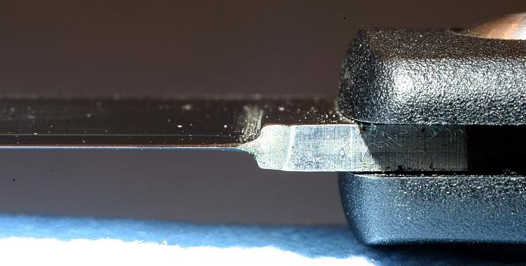

how thin did you go down with the edge?
do you have a shot showing from the tang up to the edge?
again, very nice,
G2
edited to show this example of the edge shot
the edge was run down to .017 before heat treat and i cant run it any thinner before but if someone wanted a real slicer i can run a zero bevel just not with heat color (you should see the straight razors im working on)
nice edge on shot of a fallkniven? looks like the edge was put on at about .010 bevel grind
Good eye, yes that's the Fallkniven U2 folder with laminated blade.
