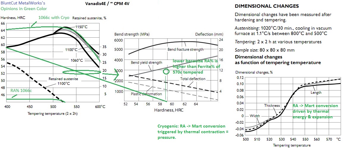

I agreed with Nathan's assessment above. As for LTT (low temperature temper) vs HTT (high temp temper) - there are quite a few major variables involved. I think 'Bend Strength' and 'Dimensional' are key variable for edge tools. Pic below is my reluctant mini-blah about it. With some staring + simple deduction in physical world (+ whatever published data out there), you might find reason why LTT (with Cryo) might has advantage over HTT in edge tools. As for extra wear resistance - I would just use steels with higher carbide volume than getting it via HTT.
*dimensional changes: think of a huge packed cube of lego blocks/grains of different sizes and shapes. Increase size = increase stressed (dislocation). Fair to ask - at working dimension of LTT & HTT, which one has lower dislocation? Oh sorry, I blah :foot:
