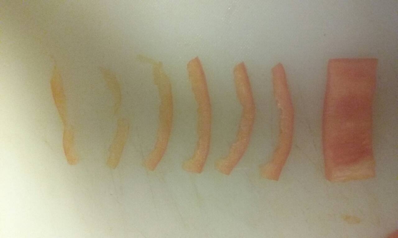

Well just got my 7 out of he mailbox and have to say this thing is amazing. Josh really went above any expectations I had on fixing the edge. All I was originally looking for was to have the recurve taken out of the blade and to have the tip corrected. Josh recommended I go with a zero grind to improve its sliciness. I was a little unsure as I use my knives for all manner of stupid prying tasks but I went with Josh's higher level of experience in eds geometry. He managed to leave the thickness at the spine while greatly increasing the cutting performance.

Would love to see some pics of stuff cut up and some use if you have time! :thumbup: feedback on performance is great because it lets me know if I need to change anything up or dial it in more.
I know you didn't mess that edge up, I hope I didn't imply that above =) And for the record it isn't quite zeroed, it does have a small bevel :D
I know its just fold prep but the last picture shows how well it slices. With patience I can get it thin enough to read print. it even push cuts nicely (even if it's something I never really do).

Seems to be working out nicely. It's 10x better looking that's for sure.
Looking good! Thanks for the pics 😊
