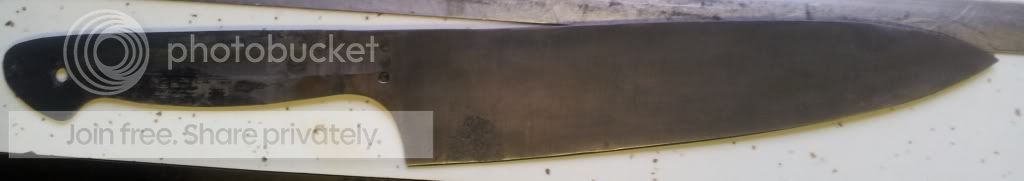

My brother had asked me to make him a set of kitchen knives rather than buying them at a store and I accepted his challenge. My first thought was to buy some blanks, put handles on them and call it a day but I wanted to give him more than that so I began forging one out of 1084, which is the only steel I have used so far outside of stainless, which has been sent out for HT.
I started with a 3/16 x 1.5" bar and cut the profile out. I knew it would be a difficult grind as I wanted both a distil taper and tapered tang with bolster.
I started by cutting out the profile, drilled the holes, then forged the blade out to 2". I normalized it 3 times in the forge first a bit above nonmagnetic, then at nonmagnetic, then just below nonmagnetic. Then I brought it back up to nonmagnetic and set in pearlite to cool overnight. In the morning it was warped pretty bad but I wasn't too concerned because I was able to straighten it out with a 3 point jig and light taps on the anvil.
I cut off the excess length that was created by forging and was very happy with it. I cleaned it up a bit and started the tapered tang as well as a bit more of a distil taper. I din't start on the bevels just yet because it was already at 3/32 so I figured I'd go ahead and heat treat it.
Today I put clay on the blade hoping to get a temper line and heated it to 815c (1499f). During the 10 minute soak, or rather while the blade was coming up to temp, the kiln fluctuated between 815c and 818c (1499f-1504f) then quenched it in 120 degree P50. I did not pull the blade out of the quench until it was pretty cool. I may have gone wrong there.
While I was cleaning the oil off the blade and getting it ready to temper I heard that dreadful *TINK* and sure enough it cracked.
If you look at the pics you can see that it cracked where I went a bit too far while forging. I was trying to draw it from 1.5" to 2" and may have gotten too thin or uneven on the heel of the blade.
Aside from forging it too thin, where did I go wrong?
I have not broken it apart yet to look at the grain. I was wondering if I should temper it first or look at the grain pre-temper.
