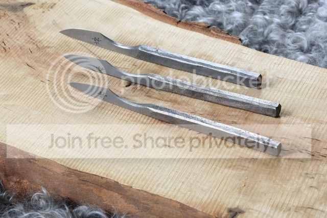

Craft scalpels photographed before shipping to friends

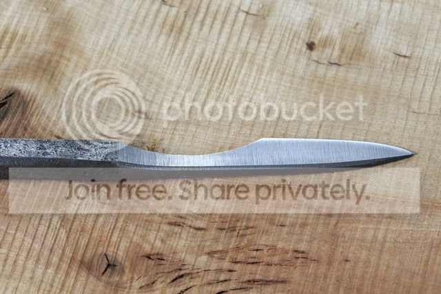

The knife that's highest up in the top image is 01 tool steel (arne) ca 58-60 hardness the bottom two are spring steel ca 55-57 att the hardness scale. They are flat grinds at 20 degrees with a polished micro bevel.

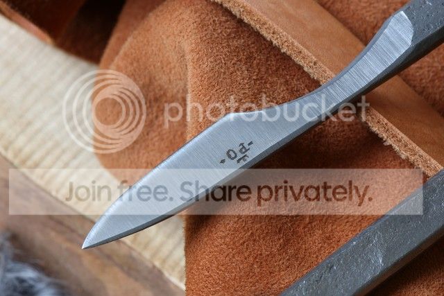

If they will be used as scalpels probably a mirror finish would be appropriate and also getting rid of the maker's mark, at least from the blade.

If the edge was straight from heel to tip, those would be perfect kiridashi.
