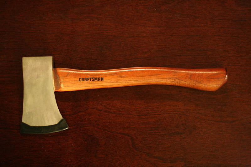

Here is yet another affordable hatchet review. For this one I will be looking at the Craftsman 1.25lb Camp Axe. The axe head has a clear coating, which I removed before the testing.
Specifications:
Manufacturer: Sears
Axe Head Weight: 1.25 lb
Axe Length: 14 inches
Axe Head Material: Unknown carbon steel
Handle Material: Hickory
Cost: $17.00
This is not the cheapest hatchet on the market, but it is still what I would consider a cheap hatchet. The reason why I wanted to test it is because it has a very good and solid look to it, and I wanted to see if the performance would keep up with the expectations.

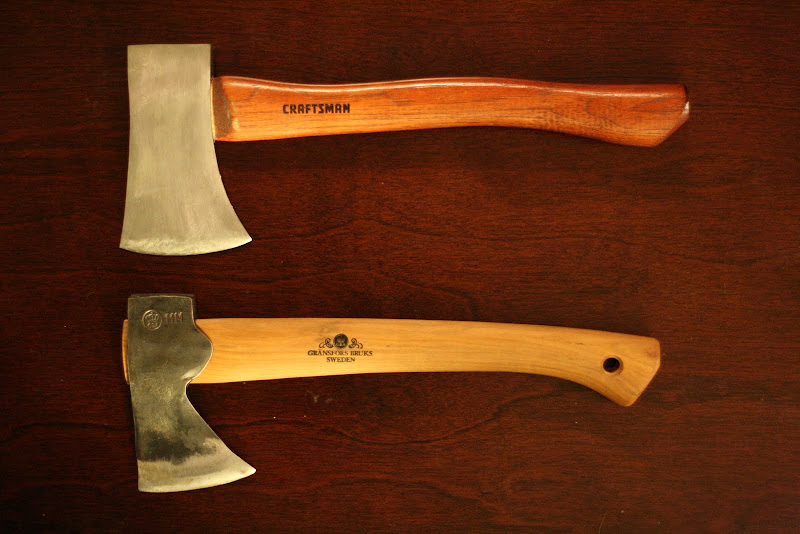

Here you can see the Craftsman 1.25 Camp Axe next to the Gransfors Bruks Wildlife Hatchet.

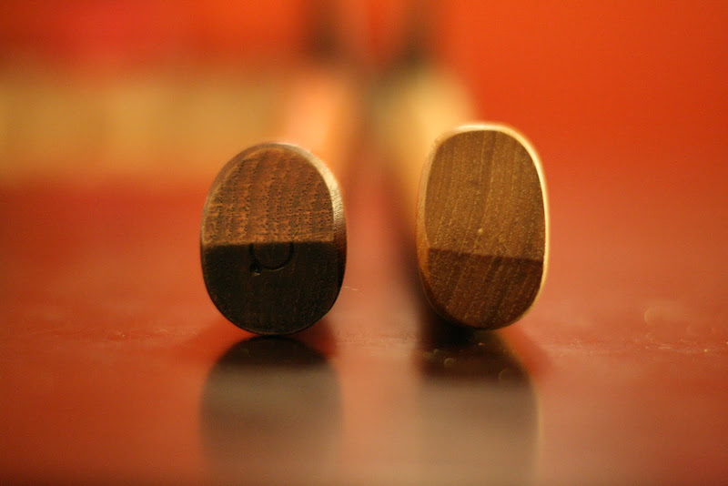

The handles of both hatchets are rated at 14 inches, but while the handle of the Craftsman Camp Axe is exactly 14 inches, that of the Wildlife Hatchet is closer to 13.5 inches, accounting for the difference in the picture. The handle of the Craftsman Camp Axe is comfortable and well finished. It has clearly been stained.
The grain of the handle (left) is very good. Even though it is hard to see from the picture because of the stain that has been used on the handle, the grain is almost perfect.

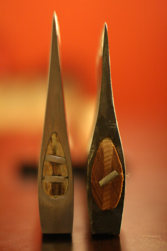

The head of the Craftsman 1.25lb Camp Axe is a quarter of a pound heavier than that of the Gransfors Bruks Wildlife Hatchet. It is attached to the handle using a wooden wedge and two metal wedges. The hardness of the metal is unknown, but did not seem to be particularly soft in any noticeable way.

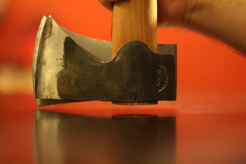

The head has a good overall grind. The cheeks are narrow and the eye is not too wide. The convex of the edge however is fairly wide and thick; much thicker than that of the Wildlife Hatchet. In fact, the cutting edge itself is formed by a small secondary bevel at the tip of the convex grind. The hatchet came completely dull and required work to bring it to a good sharpness. Just like with all cheap axes, I would recommend using a 200 or so grit metal file to start the sharpening process. It will save you a lot of time.
When it came to performance, there was no comparison between the Craftsman 1.25lb Camp Axe and the Gransfors Bruks Wildlife Hatchet. The Wildlife Hatchet significantly outperformed the Craftsman Axe. This was no surprise considering the thick convex grind of the Craftsman Axe.

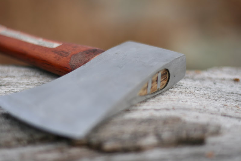

That is when I noticed an even more significant problem with the Craftsman 1.25lb Camp Axe. As you can see from the picture, the head started to come loose from the handle.
That is an unacceptable failure of the product, as it makes for a very dangerous tool. It also means that the axe has to be re-handled, a task not every one wants to undertake.

Good review. handle dry out as they sit around the store. might try tapping the handle end of the hatchet down on a block of wood or tapping on the end of the handle with a rubber mallet or dead blow hammer then set it head down in a bucket of water some people will say to use linseed oil or somesuch as that. I use to do this every fall to my splitting maul every fall as the handle dried out and would slide loose while splilling wood. this would fix the problem for the wood burning season.
Test them splitting wood and the thicker axe will do better.

These Craftsman hatchets are manufactured by Vaughan and Bushnell for Sears.
Until 2-3 years ago they did not have the metal wedges. I guess they started using those as an "improvement". Unfortunately, it seems it's not working. As I have seen in many cases, they cause splits similar to the one visible in your picture. I think these wedges are too big for such a narrow eye.
I don't know if this has contributed to the loosening of the head, but it definitely does damage the handle.
