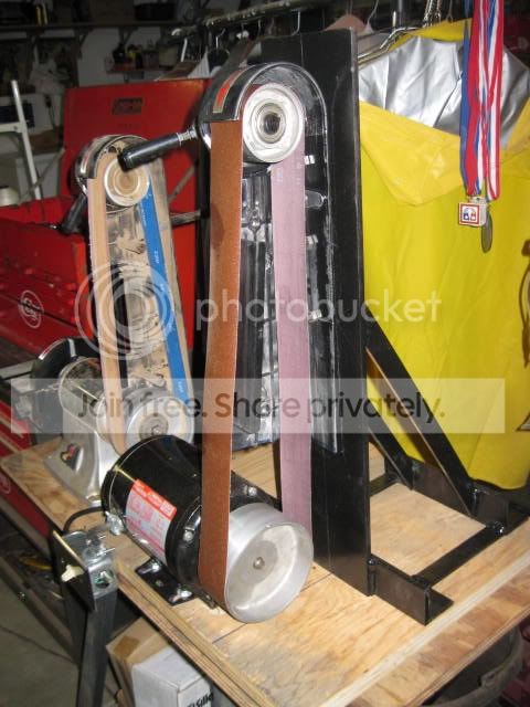

I was gifted a lifetime supply of 2 x 48 belts....about the same time another buddy upgraded to a 2 x 48 belt sander, so he didn't need his 2 x 42 Craftsman any longer... he keeps the motor and gives me everything else.
I literally just cut the housing in half just under the platen mount, mounted the top section with tension unit/tracking wheel intact to the tower, and this is what I end up with.
The motor is a Dayton 1/2 hp, 1750.....so not quite as fast as my 2 x 42 standing along side.
I ask my iron worker bud to bend a piece of angle iron for the tower, and he comes back with this....I guess he's used to building bridges.
I managed to wire it up without burning anything down.......and BANG!!!
It runs like a top!! I mean it hums!! Much quieter than the 2 x 42.
I'm not a knife maker, so won't be doing any serious steel grinding, but will suit my tinkering and leather work needs just fine.
If you see any glaring no-nos, please let me know...I engineered this myself, so I know there must be something not quite right.
I need to extend the platen out some, so a trip to my iron worker bud is in order again.......there goes another 12 pack.
Most important, it was fun bringing it all together....with help from some good BUDZ!!!
