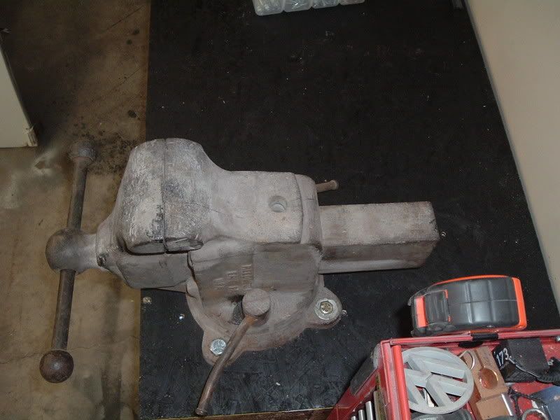

This photo is a good example of a point I'd like to make
Notice that it IS bolted to the table
Also notice that the back stationary jaw is set back on the table too far
When you mount a vise to the table, you should mount it so that if you put a long piece vertically in the vise, it should be able to clear the table.
It should be mounted so that the back jaw is just a touch forward of the table edge
Like this
http://img.photobucket.com/albums/v391/tuned20v/viseII004.jpg
Like this
Like this

The first vice in this post has a swivelling rear jaw which allows it to clamp tapered work. The tapered pin, that locks the jaw into the parallel position, appears to be missing. If the jaw is not moving, it is probably rusty inside.
