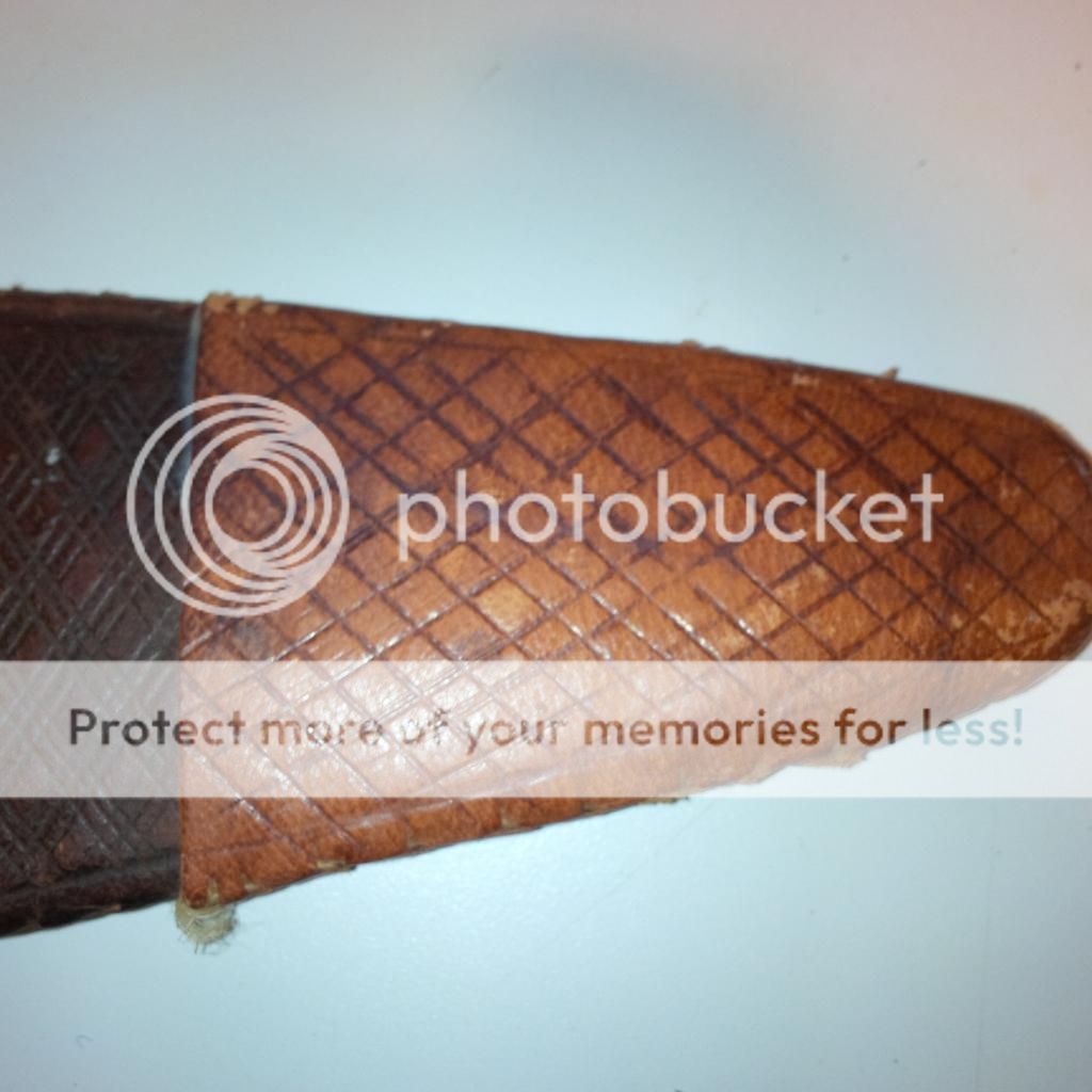

You may be right, maybe it's supposed to look a bit darker.
Top half with clear shoe polish, bottom half without. Definitely less discoloration.
Blue- beeswax darkens leather on it's own. It's what I use on sheaths for that very purpose (and to stiffen/preserve them, but I like the color). Gehazi-what type of sword? I wouldn't submerge anything old-an I have no idea what natural resin/adhesives ( Indo and Filipino stuff is held in with resins similar to laha, and Indian Talwar (!!!) are generally partial tangs set in resin inside the steel hilt) for some reason I remember reading that oil can make some natural resins go caddywumpus if they're saturated.

I suspect that will darken a little- all my shoepolish experience was spit polishing jungle boots...
I'm not expert but you take anything, like wood for example. Put a little water on it and it'll give you an idea what it will look like when it's oiled. You take a leather sheath and put a little water on it and it will darken instantly.
I'd experiment of course as I see what your wanting to accomplish but even clear shoe polish if it's doing anything to preserve or nourish is gonna darken. Some stuff might lighten back up better than others.
What do the leather guys around here put on leather that they want to keep natural looking, not dyed black or brown etc but natural?
Kind of fun trying to figure this out really. Good learning experience.
I'd love to know that too. What's good for light colored leather that won't darken it or make it harder/softer? I'm not trying to restore or rehydrate the leather, all I'm interested in is keeping it from getting any worse.
Also, it's only going to hang on the wall and collect dust, it doesn't need to endure any actual use or exposure to the elements. I don't foresee myself strapping this Kaskara scabbard on and wearing it about town.
