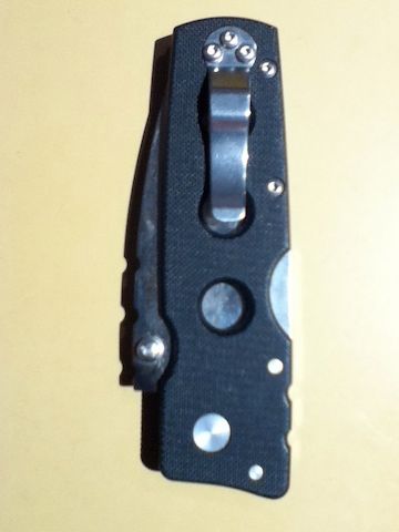

I have a fairly minor problem with my CS Holdout that I am hoping some one with some experience can help me with.
I totally love the knife. It is a great product and I like the CTS-XHP steel.
However

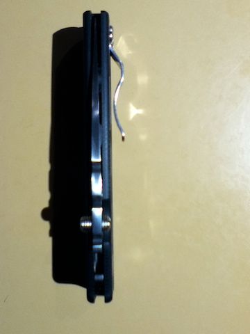

the pocket clip is way too stiff. When I got the knife I found that to pull it off the pocket of even thin pants I felt like I was going to rip my pocket up in short order so I removed the clip and put it in a vise with aluminum jaws and carefully unbent the clip a little bit. A couple of tries fine tuned it so it held onto my pocket well but was removable without calling on a passing stranger for help.
See the gap between clip and side of knife shown in the first photo.
Now that it is winter I am wearing heavier work pants and those pants have a zippable pocket. (back pocket) Duluth work pants . . . good stuff, if you haven’t, check them out.
Every day when I pull the knife off my pocket it feels like it is going to tear the zipper off the edge of the pocket. So now I am at the point where unbending the clip more will screw me up for thinner pants.
The clip is just tooooo non-springy.
I am thinking of taking the clip off again and thinning the thickness of the clip so it flexes easier. As it is it is as if Cold Steel designed it to hold up to parking your car on the pocket clip without it crushing.
aaaaaahhhhhhh I won’t really need that kind of durability so . . .
my question is where abouts along the length of the clip is going to be the best area to thin out ?
Will I be able to do it with a file ? I am thinking it is hard enough it may take a diamond file (I have a whole pile of those in various grits so I’m good there). Probably would take too long using some zirconia alumina sand paper right ? Maybe not ?
Should I keep the upper area near the screws and the bends thick and go for the flatter area so I don’t make a stress riser ?
Cold Steel dudes ( and dudettes) if you are reading this ship me a thinner second generation pocket clip. Please.
If I'm reading you right, you want the clip to fit the heavier pants without having to bend it anymore.
Here's what I would do- I would make a spacer out of a piece of 1/16th" thick aluminum to go between the clip and the knife under the screws. And if necessary I would use longer screws. That way I could adjust the gap between the clip and the knife without messing with the clip (just add or remove the spacer). Making a spacer is a zero-risk option.
But that's what I would do.
I personally would be reluctant to go grinding on the clip because it's already pretty thin. Metal that's ground off cannot be put back on. And I don't know if Cold Steel sells pocket clips or if they will send you one for free if you screw yours up. If you can get a new one easily enough then it's not as much of a gamble to experiment.

The clip is very short. That's part of the reason it's so stiff.
Don't try to thin the piece- make it narrower. You should be able to use a regular flat file.
The screw pattern LOOKS like it may be fairly standard. If so, the knifemakers' supply houses sell pocket clips-get one that's longer.

Make it narrower
Well that sounds too easy. Where's the challenge in that ? :D
You're probably right though.
Have you done one that way ?
Thanks
I make leaf springs all the time. Thin springs should generally be weakened from the sides.
I got tired of trying to teach Holdout clips not to eat my pants yet still hold tight, so I banished them outside. A non-grinding solution is to pop the clip off and thread a piece of micro cord through the rearmost screw hole--it just fits if the end isn't burned to a glob. Pair up the ends with another strand to get 4 working ends, and you can braid an Endless Fall straight off the end of your Holdout. The great thing about using micro cord is that the braid has a great deal of structural integrity and will stay straight in the pocket or out against gravity. Finish it off with something like a key ring or one of the Grindworx knuckle beads bladehq is often sticking in as a free gift, and it makes for easier access than a clip. Holdouts are wide and flat and tend to stay put in my pocket, and the tail sticks out like a little anchor to keep it in place.
