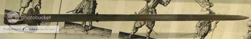

I finally uploaded the museum pictures of the type of sword this is derived from. These proto-mortuary/early basket hilts aren't things you see a lot of in the museums as they were considered 'munition grade' and were of generally poor quality and minimal craftsmanship. The customer was wanting more of a cutting than a thrusting blade.. so the profile on mine has more curvature and some flowing lines.
You can see in the second picture how the knuckle bow and clam guard were forge welded together. My first version of this was done that way.. but I deformed it to such an extent that I decided to NOT do it on this version. On the second sword in this commission I'm going to give it another shot. The other option would be to do the entire thing from a single piece of plate....

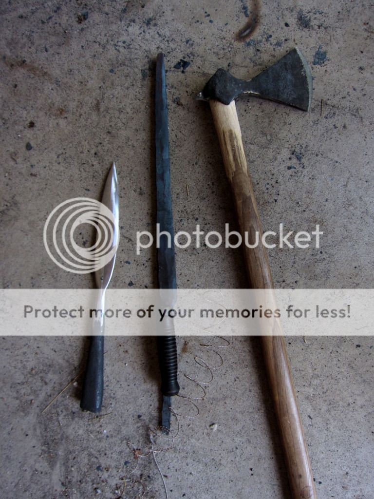

Here is what I was occupied with today... just for the sake of putting some pictures in the post.
A Viking war axe, a Viking socketed spear made from low carbon iron that will be carburized in a historical fashion, and a rondel dagger with twisted wire prepared for grip

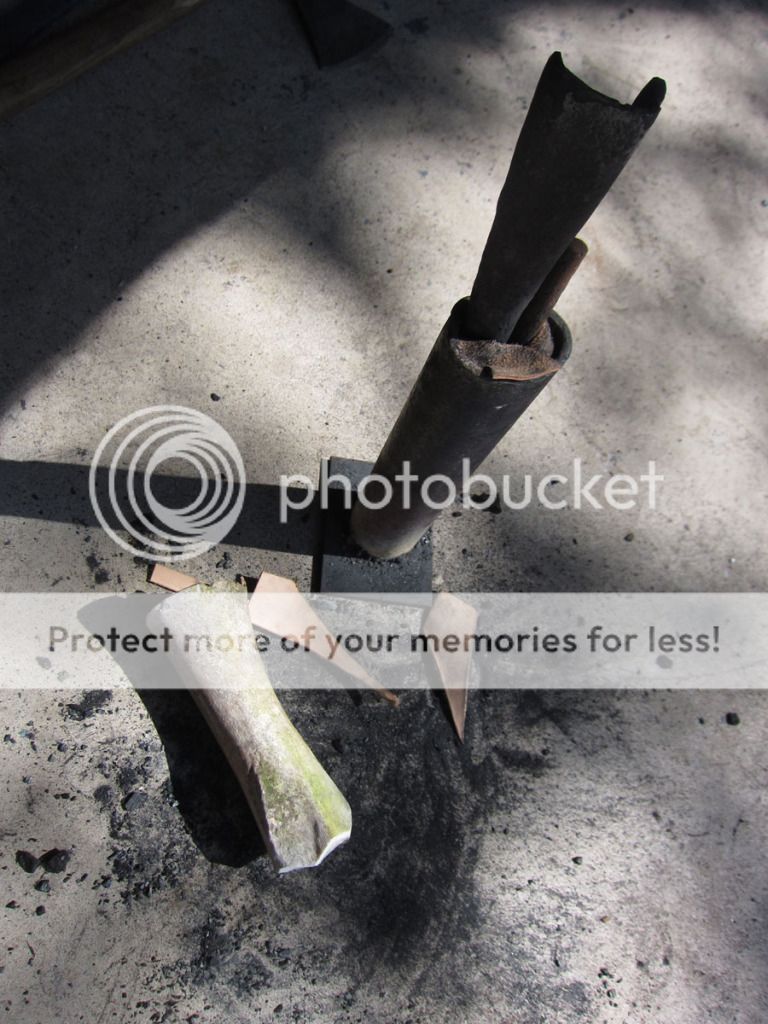

Here is the spear going into a canister with charcoal, leather and bone shavings:
