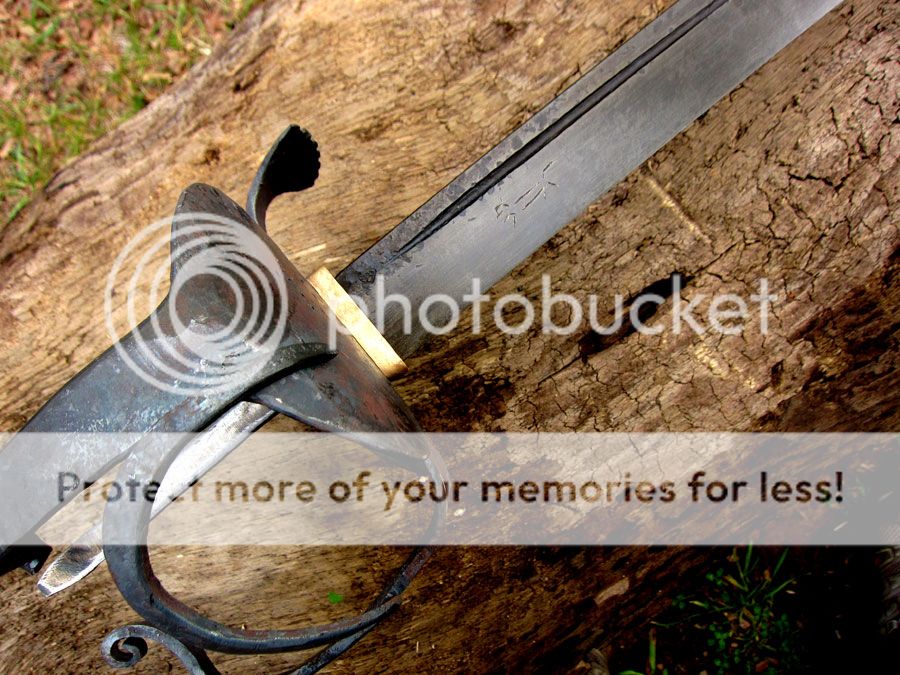

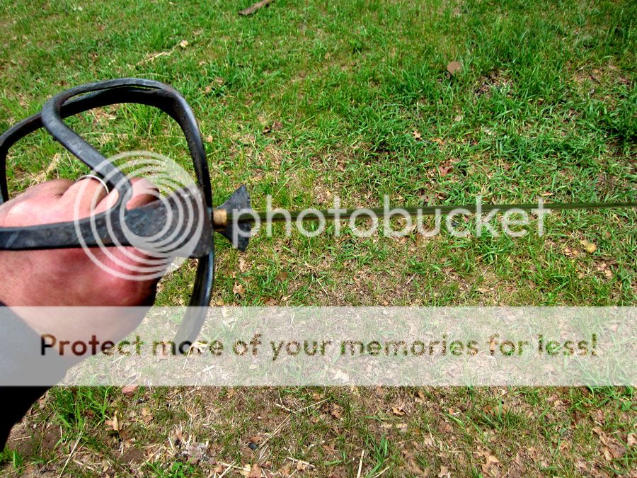

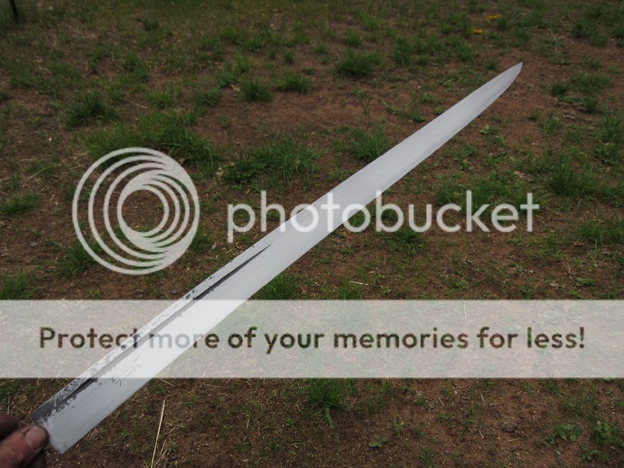

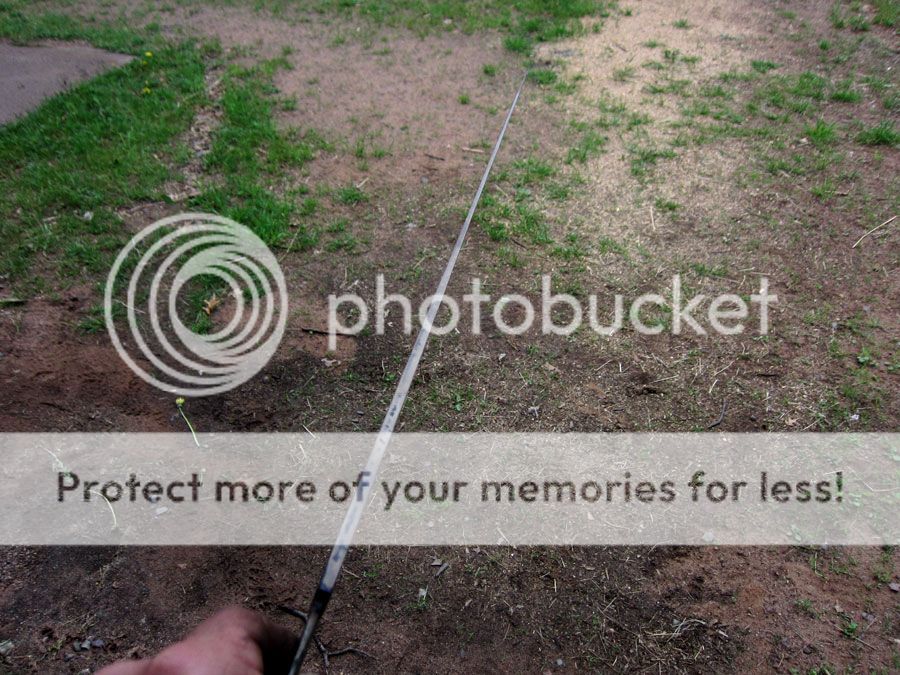

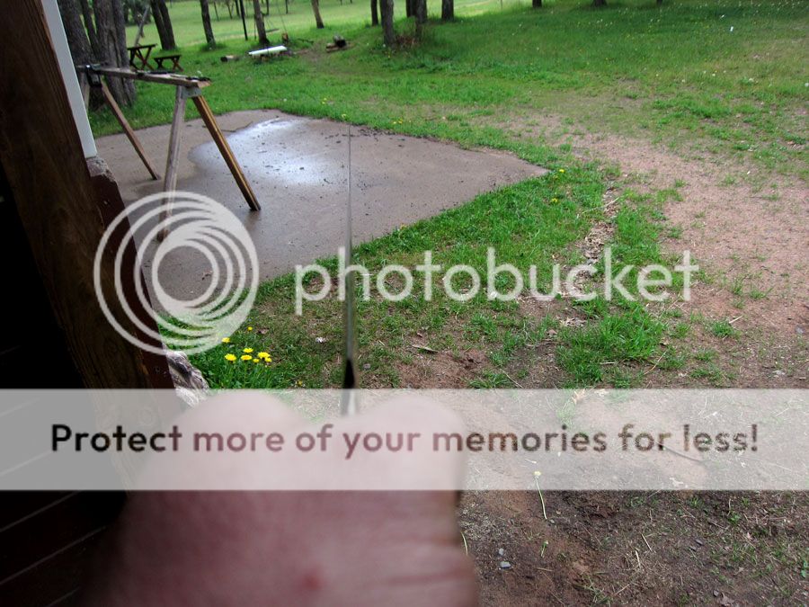

Okay I have the blade pretty much finished. A bronze spacer fit.. now it all just needs to go together. The following pictures are a loose mock-up of the assembly.
I'm very pleased with how straight I got this thin blade.. and I owe much of that to my vertical heat treat forge with muffle which gave me an incredibly even heat. As well as my new disk grinder which greatly aided me in keeping things nice and even on the grind.
Anyway.. most of the work will now be focused on the hilt and grip.
That's so slick, Scott.
The distal taper looks even and wicked.

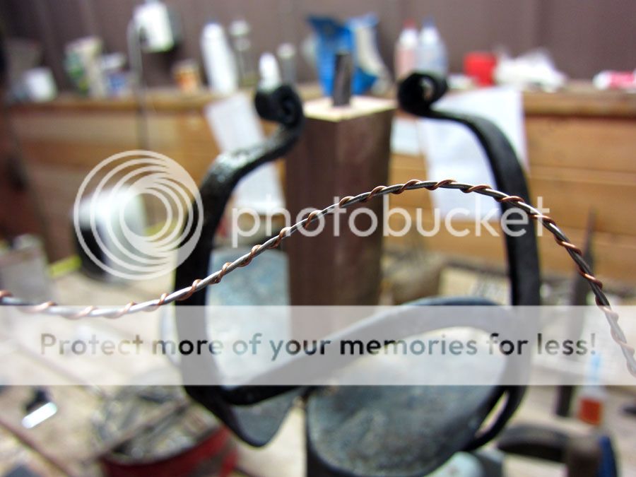

And here is the sword preparing to be hilted. I have the morticed English walnut in place.. getting ready for pommel fitting. And a view of the twisted wire that will be placed in sections along the walnut.

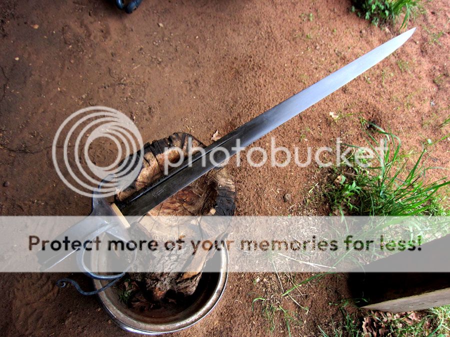

Well it's done!
Final specs:
37" Over All
31.5" Blade
3 Pounds 4 Ounces Total Weight
4" Point of Balance
21.5" (from guard) Center of Percussion (this is a measure of the harmonics of the blade)
Thanks for looking... and I hope my pictures and posts were informative.
