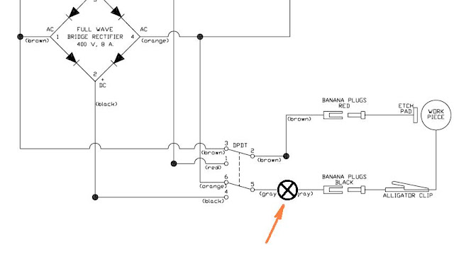

A few days back I received my stencils from Ernie Grospitch, so I decided to go ahead and finish up my Crawford etcher. I built it exactly as shown on Chris' webpage HERE using the exact part numbers from Radioshack. I wired it up to 12V output per THIS ONE-LINE.
My problem is that I keep blowing the 1-amp 250volt fuses when I flip the power switch on. The LED will come on for approx. 5-10 seconds, then will go out once the fuse is blown. I have done this multiple times, and have checked the wiring repeatedly.
As a test, I removed all connections from the load side of the transformer. I still blow the fuse. Anyone have any ideas? Should I increase the fuse size to either 1.5amps or 2amps to match the transformer rating?

Normaly this would indicate a short in the wiring. you need to trace out the wiring and make sure that they arent crossed acording to the schematic. since the transformer isolates the low voltage side from the fused side, I would check the power to the transformer first. A bigger fuse will not solve the problem. More than likely it will be in the switch or light wiring.

People, I am an elecrician. Just conect electric bulb according to your output voltage and in case of shortcut the bulb will became to glow, and the process will continue. I added a bulb on mine and it is working fine. It works!
You cannot avoid the shortcuts while etching. Profesional etching equipment has a resistors, but with a bulb, you will see when you are pushing too hard. If the bulb glows - the process is stoped. elecricity must float through the acid, not the electrode, that touches the blade through the cloth.

Your idea for a bulb on the low-voltage side of the transformer is a good one. Unfortunately, right now it appears that I am troubleshooting a problem on the 120V side of the transformer. I am blowing fuses with the low-voltage side completely disconnected.

Erin, change the transformer. Sometimes when transformers works in a shortcut mode, which etching is - the insulating cover of the loops burns out and when you load the system - sparks occurs between the loops inside the traf. Change the transformer, and if it works - add the bulb.
