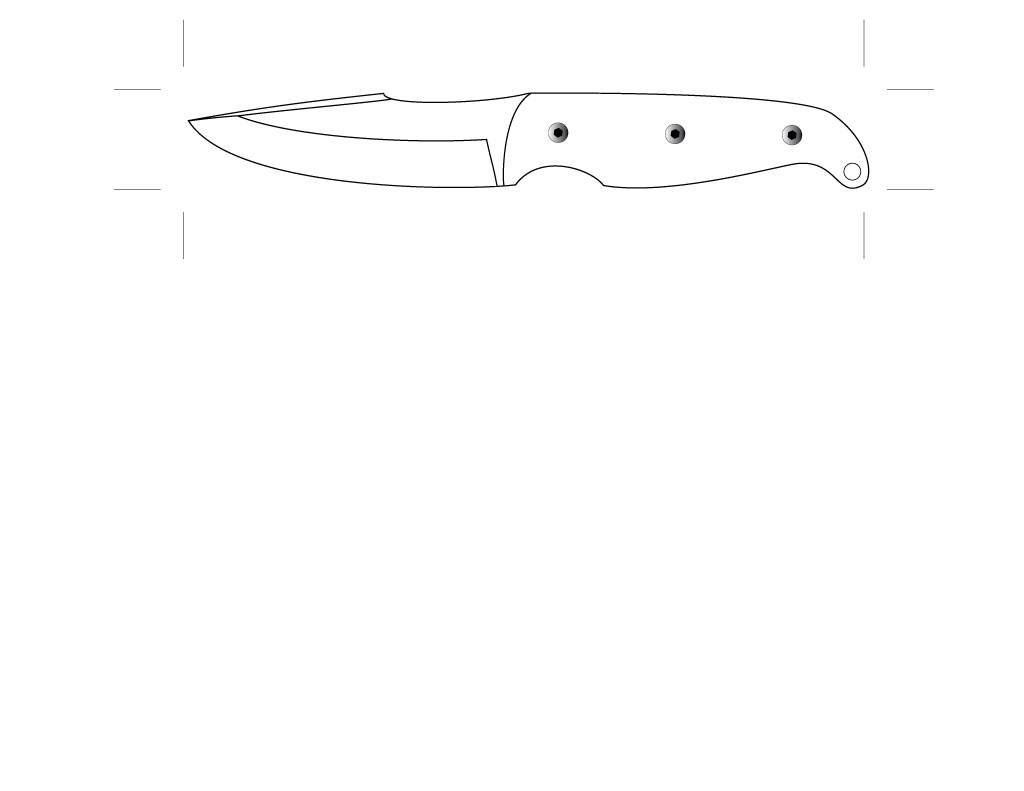

With my grinder almost finished and most of my first shipment of knife making supplies on hand, I am trying to decide on a design for my first attempt. This is about 7-1/2" OAL and will be made from .125" 440c. I would like to hollow grind the bevels and flat grind the swedge and expect I will screw it up. Does this look like a workable design? Any changes you guys would suggest?

Why don't you just make it dirt simple for your first knife, or even first few. Your design is a bit much for a beginner, and even for some with experience. In my opinion.
I like your design. I guess one could argue against the added complexity of a swedge on your first knife. Even the handle shape could be less contoured just to give yourself practice with grinding. But yeah, the design looks good.
RangerBobTX,
I really like the design. I would echo the advice of the others, start simple. However I did take a look at your profile. You are not a 15 yr old kid getting started but a man of some age, experience and a creative person who is practiced at working with his hands. So I say if you feel like you can meet the challenge go for it. When you are young often you don't have the patience, or problem solving experience it takes to do it right. Go slow and don't cut corners. Ask questions along the way if you need help. You got this. BTW, thank you for your service.
Your design looks great and it looks like it would be a good working knife.
One thing I see that might be a problem is that the handle material around the lanyard hole on the toe of the handle is rather thin. If the scales are wood the toe of the handle material is almost certain to break off due to short grain. Even Micarta or G10 would be to thin for my comfort and peace of mind. Could you move the lanyard hole up into the "meatier" part of the handle? Perhaps use a tube in place of the third pin?
It looks to me like you have a lot of experience in other areas than knife making, go for it!
Does the steel need to be stainless? If this will be your first knife I would suggest going with a simple carbon steel like 1084. It will make a great knife and you will be able to heat treat it yourself with equipment you may have or could make. Otherwise you will probably have to send the blade to a pro heat treatment service.
My suggestions are to drop the point a bit, and maintain the arch along the spine that the handle sets up. The index finger will then be along the line drawn from the center of the but to the tip, giving you great natural geometry.
Personally I don't like the dip in the spine of the knife and I don't like the belly after the finger groove. I'd have the spine curve from tip to butt and have the handle either taper down a bit after the finger groove or keep a consistent thickness.
So, this is actually the simplest design I've come up with. I've got several others that will certainly be more challenging. I'll be using the 440 because my 1084 was lost in the mail. Hopefully that will get sorted out soon but,I have no intentions of doing my own heat treating at this time anyway. I am thinking that I would not use the lanyard hole on wood scales. If the tearout is still too thin for G10, I might have to make some adjustments.

Well... you definitely don't lean toward simplicity. You seem to have the patience and the skill! I'd say go for it. I'll echo woodwrkr221, the lanyard hole looks like a very delicate placement, maybe you can enlarge the area slightly. The handle looks cool; I've learned to make a test handle out of scrap wood to test the feel before I commit the real thing to the blade.
What you also can do is that you leave that place 'blank'. I mean that you not cover it with the scale so the scale end just above the 'drop', something like following the line of the botum part of the handle all the way to the butt end of the handle.
Something like this:
When you design your knife try to keep this question in mind...."Why?"
If the answer is "because I like the way it looks" that is good enough....but not necessarily make a good knife.
When talking with Bob Loveless he was quick to ask "why?" you did a certain feature on a knife. His drop point hunter is one of the most well known styles for a reason.

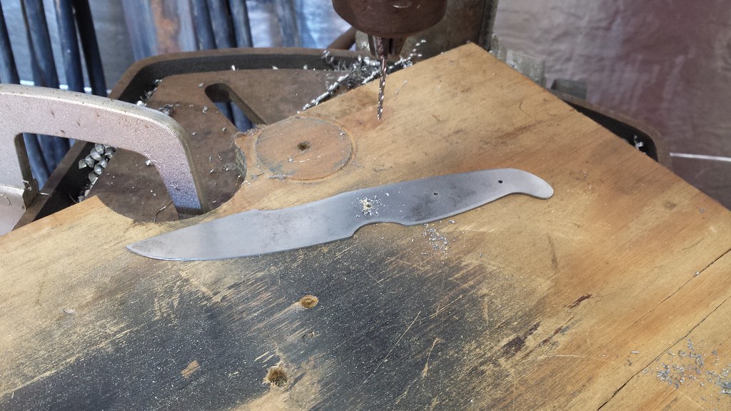

Thanks for the feedback guys! I made a pattern today out of 16ga and I am pretty happy with the size and feel. I did make the area around the lanyard hole a little thicker just so I can feel confident in G10 being able to resist tearout. I will likely explore the use of bolsters as well.
Bob
Untitled by Ranger_Bob, on Flickr
After playing with my pattern a little and re-reading your comment, I agree. Bringing the tip down a tad would improve the feel.
