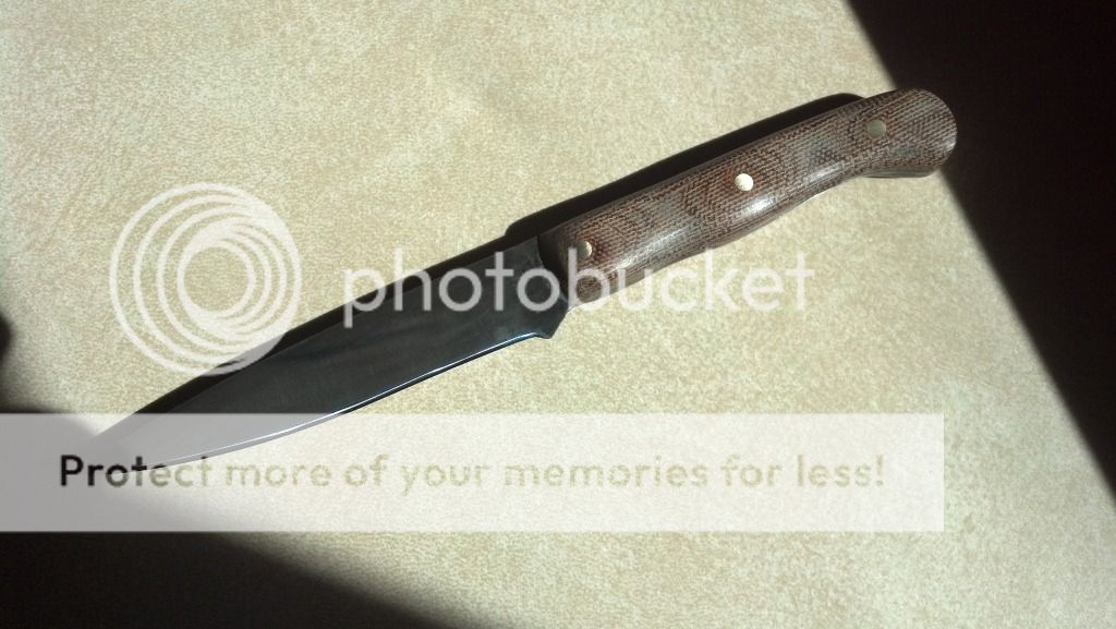

Make sure the steel is very clean. Hot water and soap will do, just rinse it well. Immerse in vinegar for an hour or two. Wash off the black stuff. You'll get something like this.
I'm not sure what the soak would do to the haft.
Agreed. Even the oils from your skin/hands will make for "unevenness" in your patina. Good tip.
If you're going to soak the whole head to do the patina, you're going to have to remove the haft.

I used a mixture of vinegar, hydrogen peroxide and salt. I let the head sit in it for about an hour and a half and it turned out pretty good. No pictures yet, but will post on the big trail hawk thread soon!

Sure, but I wouldn't dunk it in bleach for an hour with the haft on. By the way, the bleach does create pitting, in case you won't like that.
