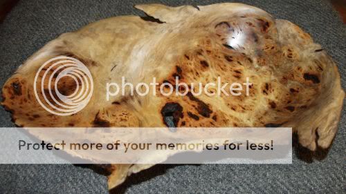

Sometimes we will microwave green burl here for our gallery pieces. Green wood is easier to carve to shape for a bowl. Then we microwave it to force distortion and enlarge cracks for a more free form tortured look. (Not what you want to accomplish.)
I have tried microwaving slightly oversized green wood blocks without success. You might have better luck than me. I would let the wood air dry for at least a few months and then try a few hours in the oven at a low temp if you really want to use the wood quickly. Best thing to do though is give it a year per inch of thickness to air dry.
