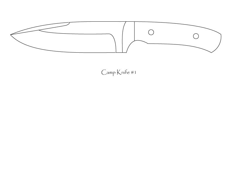

This camp knife will be my third design that I try making. It is the largest so far at 1.5" wide and 10" overall length. I'll use 5/32" 440C for this one. The bolsters will be 304L and the scales will be G10. I am open to any relevant comments but I'm specifically wondering if the tip design will be too thin. It will be flat ground. I want it to be a good slicer for cooking but I also want maximum durability for other camp chores.

Hmmmmmm... it looks good. Although I might take out the finger groove or swedge it looks good. And thatd be after I cut it out and felt it.
Nice overall design, but I'd lose the swedge.
To me swedges are nice for showing a makers grinding abilities,but serve no needed purpose in a camp knife.
Nice overall design and I like the finger guard as a safety feature.
One suggestion on a common design weakness of knives: The proper size of the handle.

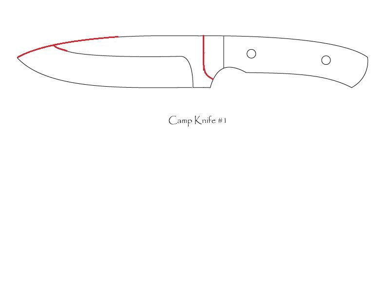

Hope you don't mind. The bolster looked revers for comfort to me... Here is what I would do. Or, possibly a clip point instead of the drop. That is just if you want a swedge and to make it pointer. A camp knife isn't stabby stabby, so not much need for a swedge... I'd maybe go higher with the grind too if it is going to do any thin work. Cheers! Looks great though. I love a good camp knife design...

440C would not be my first choice, by a long shot. If you require a stain-resistant steel, consider Elmax or even CPM-154 for better toughness.

I like Eric's modified drawing much better. Shamus's comments about handle size are spot-on. It's surprising how comfortable a large handle can be in small hands; the reverse is not at all true. When in doubt, go a little longer.

I've got a lot of experience using knives in field, survival and combat environments. Not so much designing and making them. I'm trying to apply my lessons learned over the years in each of the knives I design. On this design, the handle is pretty roomy and should accommodate a large hand comfortably. I'm not a fan of knives that can potentially allow the index finger to get scraped by the back of the ricasso area. I like a full bolster or guard for protection. I get that the swedge is not something that appeals to everyone. One advantage of the swedge is a tighter turning radius when drilling or carving with the tip. I kept the swedge short on this design so the user could still use a hand on the spine for additional leverage. I think the point about the raised handle affecting leverage is true. Since I think a good camp knife should be capable in food prep, I decided to compromise on this and give it some finger clearance for that. I appreciate all the feedback and I'm not trying to shoot down all the points that have been made; just saying that I've considered most of them. Still wondering if the tip will be too thin.

The reason I drew the bolster opposite is that bolsters that run back at the top run under the hand a bit in a forward grip and leave the web of the hand riding the spine. And for looks.

I am not a fan of choils so maybe extend the plunge as close to the bolster as possible? Finer tasks would be easier then. Also, maybe give the edge some more belly? Unless, the leaf shape is what you are going for :)

Lots of interesting thoughts there Eric. This specifically, I probably need to investigate further. Thanks.
