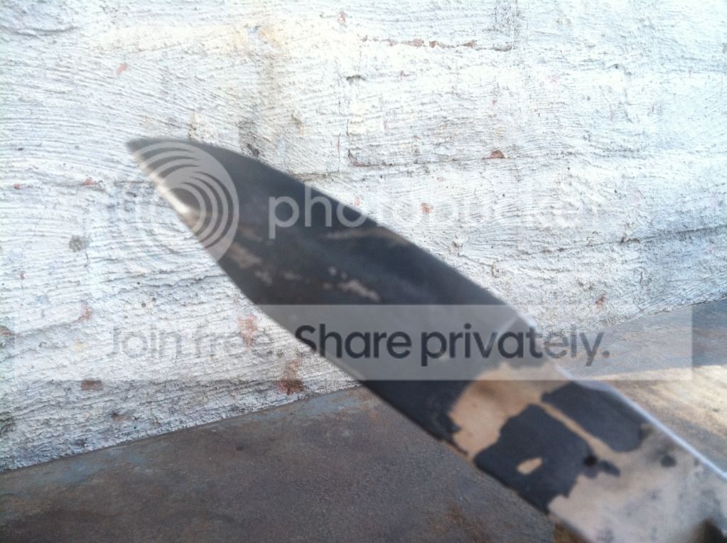

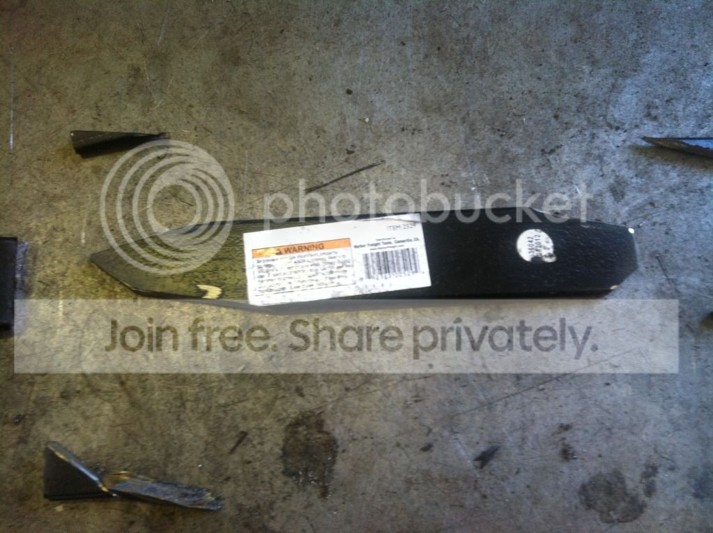

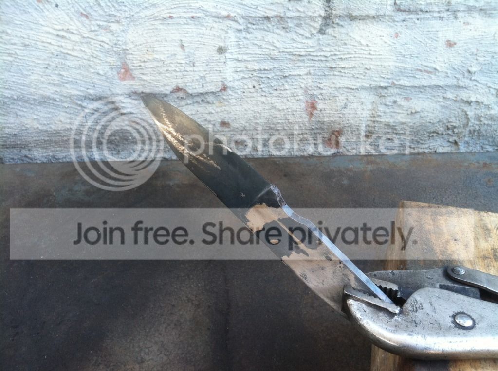

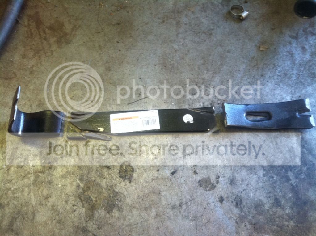

I started with a pry bar that I purchased from Harbor Freight and rough cut it using an angle grinder.
I shaped the profile with the angle grinder as well. I started the plunge cuts with the angle grinder but quickly found that it was too hard to control the flatness of my grind so I switched to a file. That took the most time.

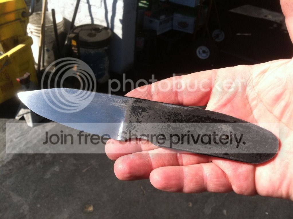

This was after I sanded the blade.
Next I heat treated the blade. I used an oxy/acetylene torch with a rose bud tip. Heated the blade to a non-magnetic state then quenched in clean 0W20 motor oil. It was handy. I next heated the spine to a dull red with the torch and let it air cool overnight.

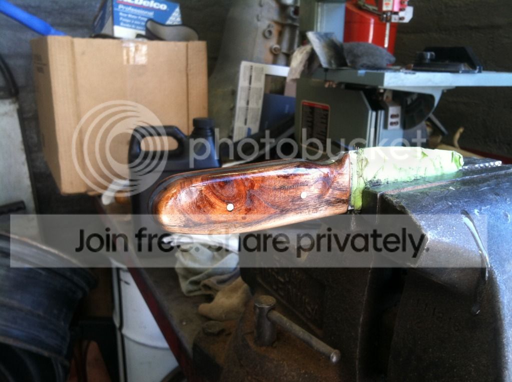

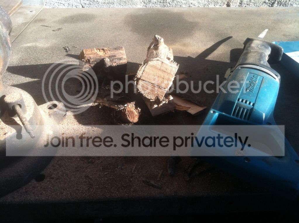

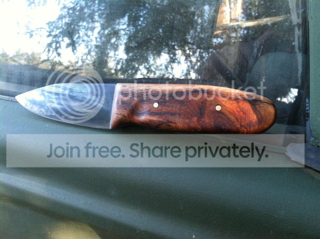

I then set to work on finding some cheap handle scales. Just so happens I had a big mesquite tree blow down at my house and the wood has been "Aging" in my back yard for over a year. Cut up a nice branch and found some suitable slices.
I gave it an edge before fitting the handle because I had no idea if it would take an edge. I did so I moved on.

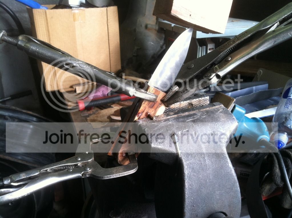

I found some brazing rod under my toolbox and I blew the dust off and used it for my pins. Mixed up some 5 min epoxy and clamped my scales on overnight.

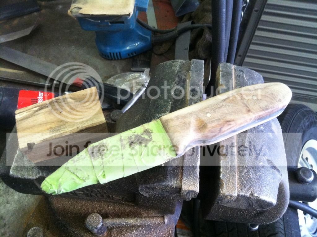

Did my shaping and moved from corse to fine paper.

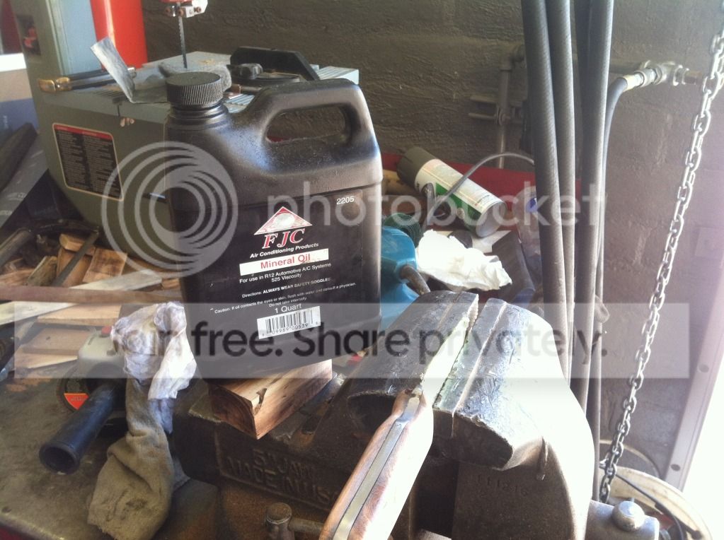

I then needed some kind of finish and found an old bottle of R12 refrigerant oil that we can't use any more for cars as it has been left open for too long. It's mineral oil so should be better than nothing.

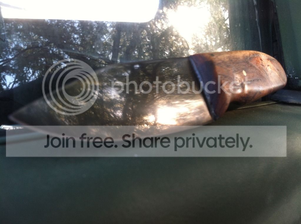

Here it is after two coats.
End of the day glam shot but it still needs more work.

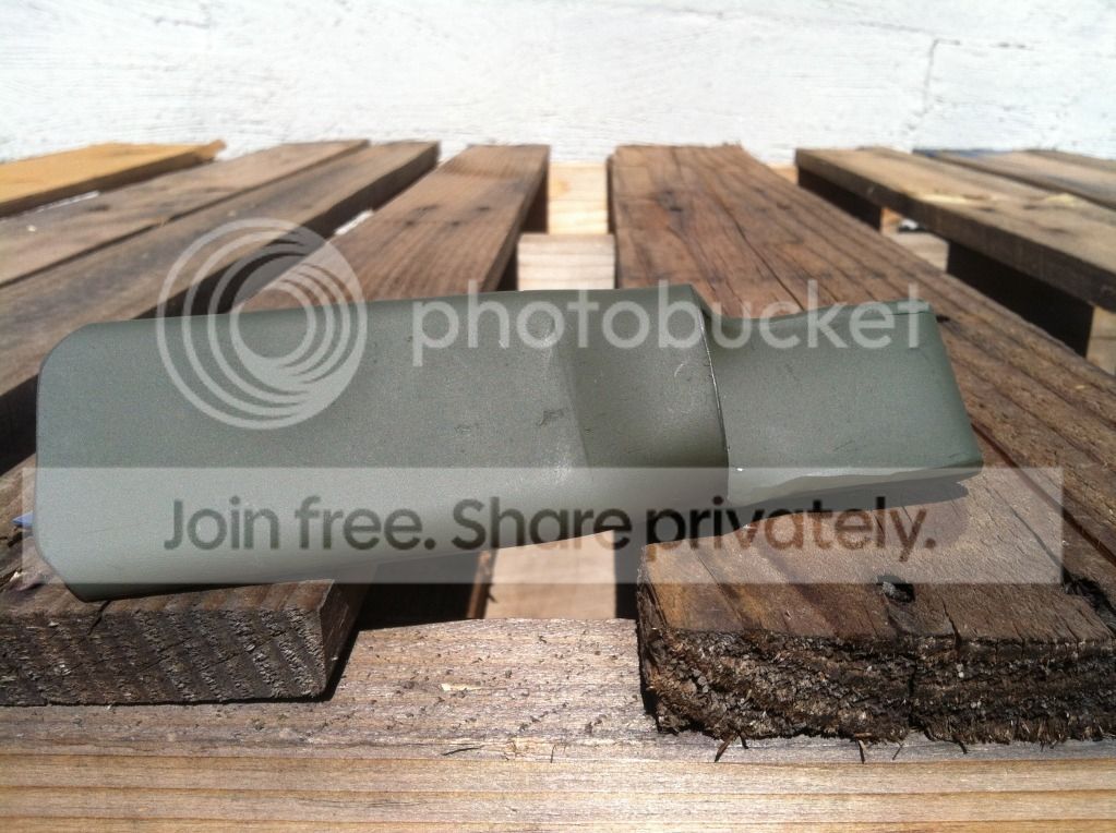

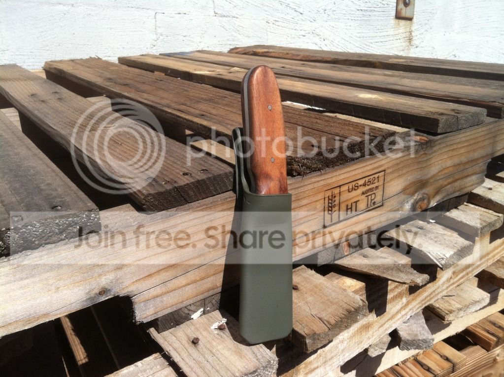

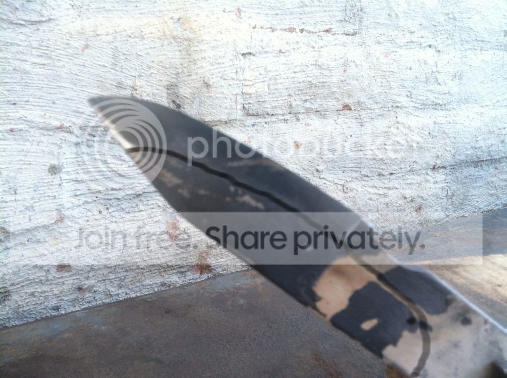

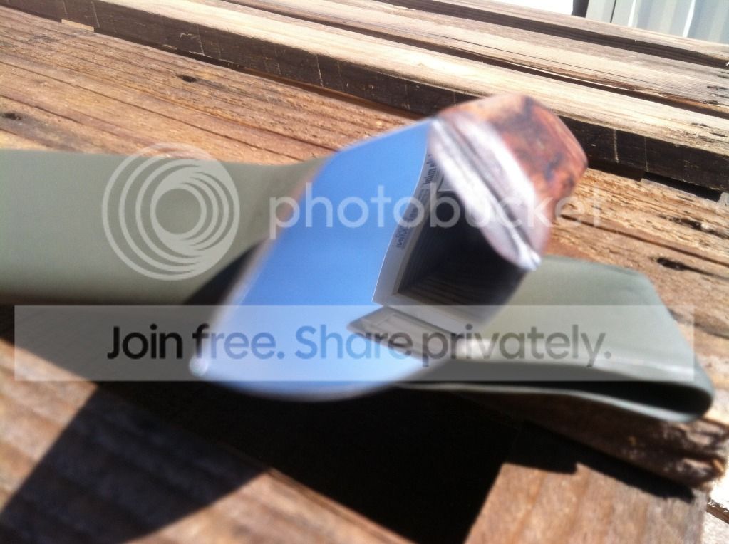

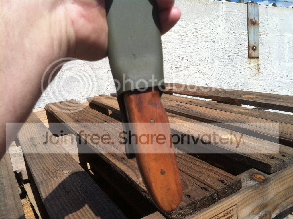

Took it home with me that night and made a quick sheath from PVC pipe. After shaping I gave it a quick coat of Krylon Camo green.
It has excellent retention.

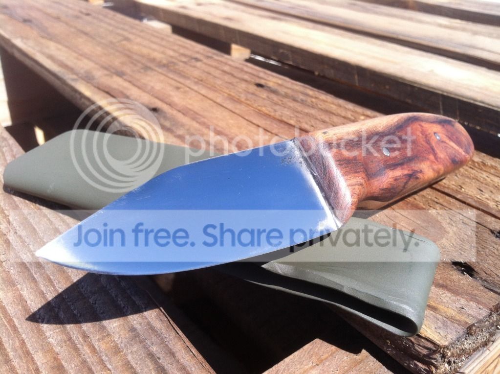

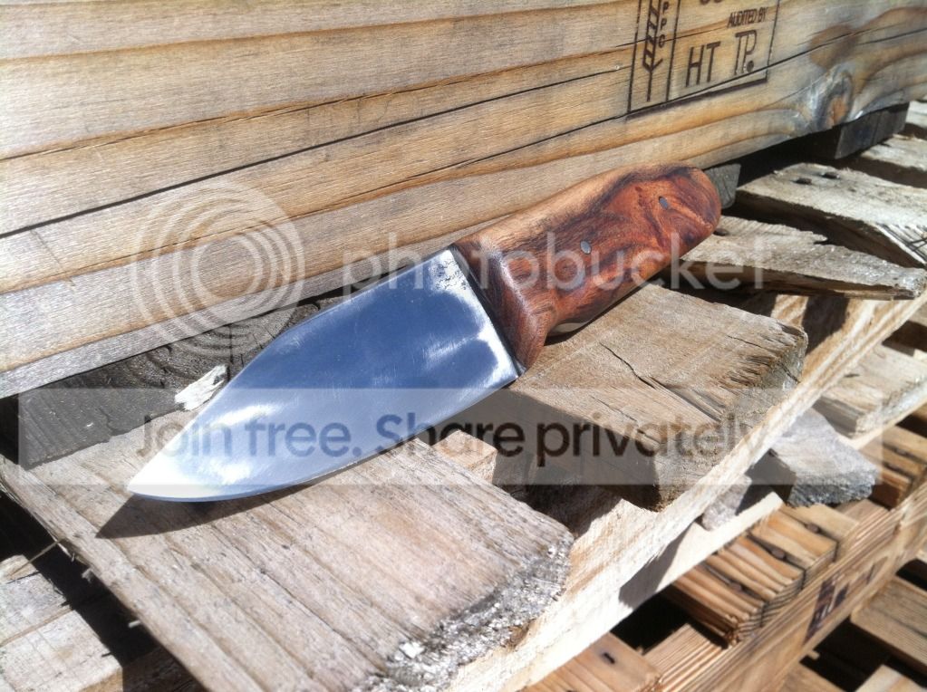

Then, as so often is the case with me, I decided to take things one step too far. I layered on cold blue on the blade. I had done this to one of my cheap hatchets in the past after it rusted really bad and since it looked good on that, I figured it would look good on the knife.
I regret it a little. I think it looked better polished in the white.
Any way here she is.

That re-defines "sharpened pry bar". For what you had to work with and your methods/techniques...oh hell...regardless of how you got it there...I think that's a fine specimen. I love the mesquite look. I agree with your assesment on the cold bluing...I would have left it "in the white" ...that polish job was amazing.
I for one think it's great. I put off getting into this hobby for over ten years because the first book I read on the subject was Bob Lovelaces book as well as watching his video. Both were great resources, but it left me thinking I had to have the most expensive machines and tools to even think about making a knife of any decent quality. I love to see people making knives out of what's on hand. They may not be the best knives out there, but sometimes people just want to make a knife right away with what they have on hand.
That Mesquite is the bomb! It's one of my favorite woods to use and that piece you have there sure has some character!

If you want it bright again, just polish with Flitz. The blue color is only a surface patina.

That Chinese pry-bar is anyones guess, but likely only 40-50 points of carbon.
Also, the HT you did may have been ruined when you softened the tang after the blade. You normally do it the other way around.

I wasn't sure about my tempering step.
I heated this section of the blade to a dull red.
I was hopping that it would act as a differential temper, leaving the edge harder and the spine tougher.
Things I plan do do different next time.
1. Primary edge will go higher on the blade, thereby thinning it more.
2. Drill lightening holes in handle. It feels unbalanced.
3. Work out more bugs with my heat treat.

The hardness is completely destroyed if you heated the blade to dull red like described and then let it slow cool overnight. That is what you do to anneal ( soften) a blade for filing and sanding before HT.
The process given in the file knife sticky would be appropriate for your knife, but that is water under the bridge now.
Basically:
Anneal the blank by heating to full red and letting air cool, then heat to dull red and let slow cool. ( not the best way, but it will soften the blade blank)
When the blade is ready for HT (and all holes have been drilled), heat the blade to non-magnetic and then a little hotter. If possible, hold at this heat for a minute or so. Quench in 120F canola oil ( motor oil isn't all that good an idea).
Temper in the kitchen oven at 400F for two hours and take out. Rinse with running water to cool off. Put back for a second two hour temper.
Blade should be around the right hardness and temper. No guarantees, but the best shot at a fair to good edge.
