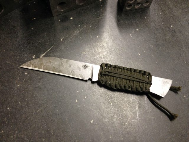

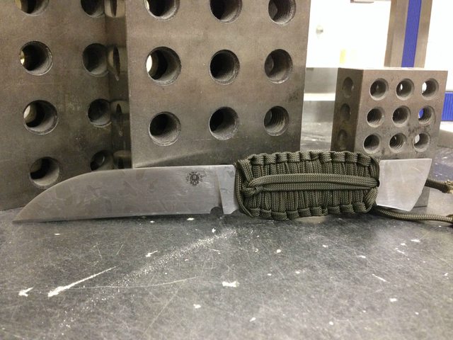

This is the first knife I've seen through to completion. The paracord is temporary, something comfy while I tested edge retention (which I was very happy with). The new owner will be adding their own scales.
1095 heat treat by Darrin Sanders (excellent service)
.180" thick at spine
Random pattern acid finish
20° secondary bevels
I think the knife would actually look very nice and perform well with just a straight and even non-gutted paracord wrap, sealed with west system epoxy. If the customer is going to finish the handle, then that's up to him I guess.

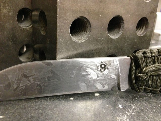

What are you sharpening with? Lansky? Looks like it may have got away from you and dug some scratches near the first quarter of the blade?
I would need to see the spine, but the grind looks a tad too high and maybe you ground into the spine a bit.
I would have added a thong hole near the pommel. Kinda breaks up that empty space, and a thong tube/lanyard is useful.
The notch near the ricasso isn't really my thing, but I can see how it aids in sharpening, and I can see how people would dig it. Just a preference thing. Might be a stress riser there.
The corner on the pommel at the top looks a bit sharp to me. Personally, I'd round just the top part over. Again, preference.
Makers mark looks really cool!
I use mustard and various acid finishes myself and I have a love and hate relationship with them. I believe this knife could have done without it.
Overall, I think the knife is a really pleasing shape, It flows really well, and it looks awesome as your first. A few issues with final blade finish, the stress riser and some handle hotspots, (alot is preference) but overall it is an elegant knife. Love the wharnies!
Josh, appreciate the feedback. I did use a lansky to establish the secondary bevel, but finished with a fine stone, which is where I believe it got away from me. I didn't notice the scratches until I posted the photo. Will try to get them out with 320 paper. They don't seem very deep.
I used a file jig to establish the bevels, and did manage to get into the spine a bit. I'll need to keep that in mind going forward.
The notch at ricasso helped me to establish my plunge lines, which I used a 1/4" chainsaw file to do. I had been struggling with plunges and this technique really got them even.
I was really on the fence about the acid too. I would have elected for a hand rubbed satin finish. I took this to 400 grit prior to FC etch and thought it looked good. But this is what my friend wanted, so i decided to give it a try. I think all in all it turned out ok.
Thanks for props on the mark. Big shout out to to Ernie Grospitch at Blue Lightning Stencil (A+ service).
Again thanks for the feedback. Love your Japanese Wharnecliffe.

Looks good Bryan. Like Josh said, most of the small details come down to personal preference. I've always found that no matter what you make, there will be people who like it and people who don't. As long as you and your customer are happy then you're good to go.
The one question I have is about the height of the grind. In one pic it appears as if you "busted" the shoulder, or ground into the spine. If you did it'll still make a good knife but thats something to work on. If you didn't then you're fine.
I see a lot of blades from new makers and taking the blade too close to finished dimensions before H/T is one of the faults I see the most. It took me a while to stop doing that myself. You can always remove a little more steel but you can't put it back.

Darrin, thanks for the encouragement. I did get into the spine a bit. Not much, but it's there. Definitely something to stay more focused on next time.

Everyone grinds into the spine! Thats just part of it man. Probably one of the first big obstacles and biggest pains for knifemakers who do the full flat. I still do it all the damn time.
This one on yours is mild, and I really couldn't tell on first glance. My first attempt at knifemaking was a big camp/kephart styled knife in ATS-34. On the left hand side, the grind is so far into the spine, it's literally halfway into the thickness of the blade.
Mild instances like yours can be fixed pretty easily with a quick vertical trip to the platen, or on a disc sander.

Josh, funny you mention that. I got all geared up last night and took it to the disc sander. And then, I decided instead of screwing up the finish I'd take it to work and check it with the height gauge first to see how far into the spine I am. It's only about .015 deep. So, after much debate I decided to let it slide and will try to take better care next time. Maybe I'll try to high flat grind next time. One of my issues is I'm still working with a HF 1x30 and getting a uniform bevel is a beast, for me at least.
