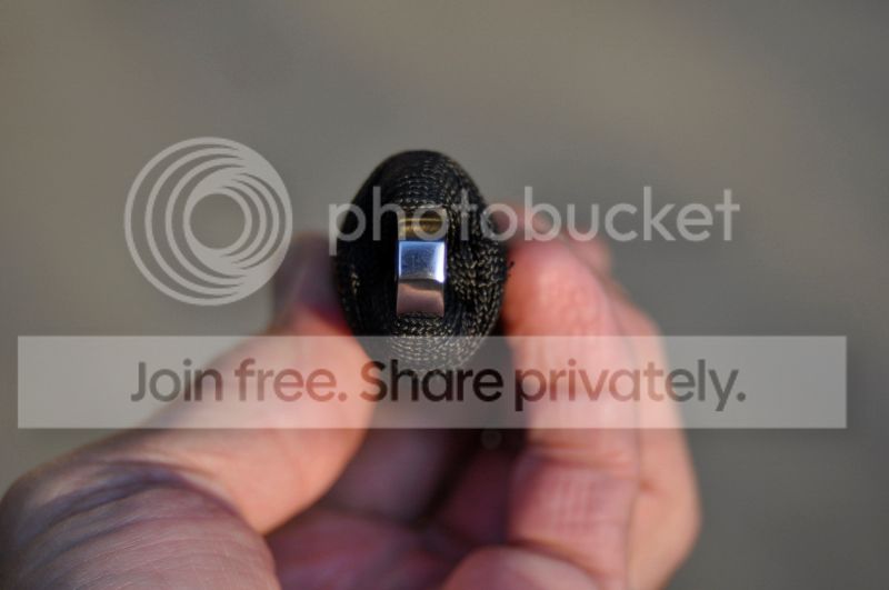

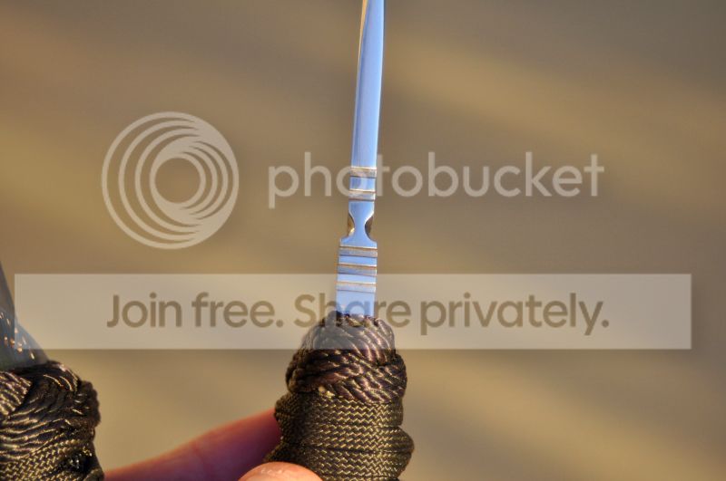

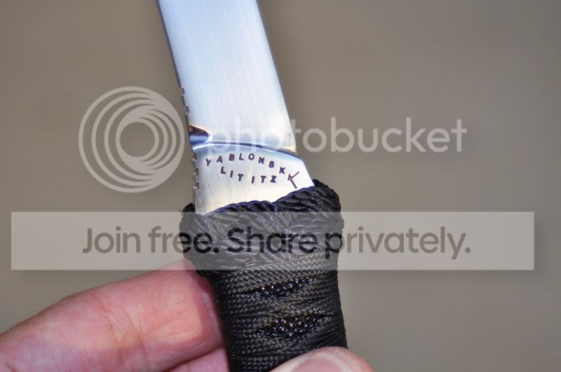

1. My biggest concern is the integral bolster/habaki transition to the blade and potential points of weakness. My goal was to have the look of handle-guard-habaki-blade. My impressionist rendition was butt-handle-turkshead-integral bolster-blade. I didn’t want there to be an additional plunge line per se but I don't want the blade to snap from a weak point. To my limited knowledge, this is relative to several variables given the steel type CPM3v: normalization before hardening, overall hardness, geometry… any others? (I used Peters and they follow the recipe and get to 60HRC) so what are the tradeoffs? How 'far' can I expect to push the geometry envelope and retain artistic impression? A slight radius at the transition of habaki to blade? Ok - How big does that radius NEED to be. I would prefer it to be as small as possible but not sure how to quantify it.

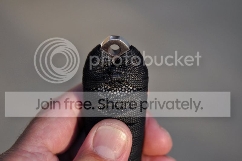

2. How do you ensure the moisture barrier at the turkshead and butt areas? (Make sure it's soaked with epoxy?) They are, but I don't have enough experience to know if there is truly a moisture barrier at those two points after epoxy has been applied.
3. If you see other design flaws that could improve performance please do point them out.

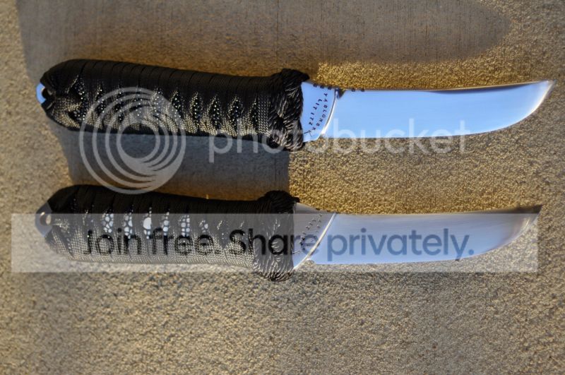

1st 6 pics are:
Steel - CPM3V to 400 grit - Peters HT to a requested 60 rockwell.
OAL - ~8.5"
Goal = Flat grind - that turned into a slight convex grind :o
Blade Length - 3.875"
Width - .8125” - spine to edge
Thick - .1875” at it thickest, slight taper toward the point.
Wt: 5oz, the other 5.5oz
Integral bolster and butt all from 1/4" stock

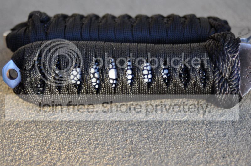

Epoxy resin (ESP155 marine/several simultaneous applications) was painted onto .25" nylon lace wrap, handle is backed with leather and heavy nylon waxed thread (same as used for the turkshead) to bulk up the handle before laminating with stingray.
Weight was reduced in the handle during the waterjet process (outsourced) by including a series of holes and then thinning the handle (files and grinding) to .1875” as well, leaving a .25" butt and bolster.

Your design and execution are both pretty spotless, IMO. As to questions 1 and 2, I think testing is in order. Your notch above the 'habaki' really does look like it could be a stress riser, but it's a really easy thing to test — make one with and one without it and see how easy and where each one snaps. From what I understand about 3v, even if the notch does increase breakability, it may still outperform other knives in its class in this area. You'll also want to ask yourself some questions about the intended use for these knives (unless you already have. If so, I'm curious.), and whether tensile strength is particularly important for the design.
The same goes for the moisture barrier issue. You could even use the broken pieces from your other tests for this. I would soak the entire handle in vinegar for a couple of days, and then take it apart and see what got etched. If you're only painting the epoxy on, you may not be getting the level of penetration you need. From what I understand, Rich Marchand, who also does leather-backed, cord-wrapped handles, soaks the handle in epoxy for some period of time.
The notch was a one time unique fix, er feature. I still have the integral transition to the blade which IS design intent. That's a bigger concern.
That had entered my mind. It IS relative to the perfomance of others. Obviously two knives of 3v are easy to compare. It is the comparison to other steel types where 3v may have a structural advantage and permit some bending of traditional design 'rules'. Is there an elasticity measurement? Maybe before I go breaking things, I'll try to do some more research.
Good idea. I have some ways to test this without destroying anything.

First, they look good. The tsuka-maki is very nice looking. The turk's head is a good feature. Milling and finish is very nice.
Those should be real rugged beasts. 1/4" is thick for such a small blade. I wouldn't worry about them breaking.
The handle looks a bit fat for the blade size. It could be the photos, but perhaps a smaller handle would be more balanced. Remember that with a wrapped handle, you need to reduce the tang width by the thickness that the tsuka-maki will add.

Hesparus - The blood and guts on the handle is a concern since they aren't dipped. I was afraid of getting too much epoxy on them and didn't want them to turn out shiny and lose some of the detail. Might have to take fish gutting off the list. That's ok. I WILL test to find out how water proof they are though. Some clean up from tree sap and dirt will be necessary and they have to be able to be maintained. They are meant to be users.

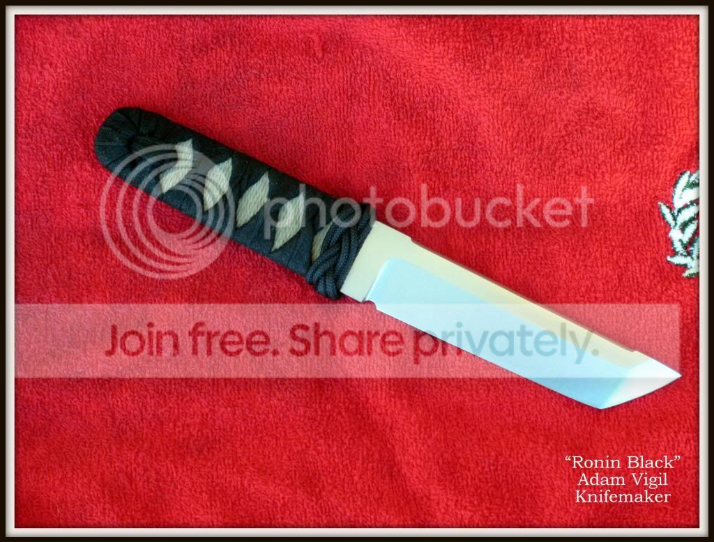

I use system 3 epoxy impregnate on my cord wrapped handles . Once cured they are 100% water proof and can be cleaned easily with soap and water, I often use windex and wipe down with a cotton towel. I also will give it a good going over with compressed air to clean out all the nooks and crannies.
When you apply the epoxy drenge it and lay it on until it is soaked, fill in any and all crevices, gaps and spaces. Turn the knife in all directions so the epoxy will flow everywhere in the handle and hang it up. Let is soak in for a few minutes. Then as Mike Snody demonstrated in his video. Take a cotton towel and give the handle a pat down to remove all the excess epoxy. I then go over it second time and repeat. Once you pat it down with a cotton cloth the grip will come out looking and drying perfect and it will be a totally sealed unit.
It is very easy to maintain with soap and water and patting or blowing dry. I use mine all the time cleaning fish and using in the camp with food. The best part is this style of grip is non slip and no matter how gooy things get your grip is secure.
This is what it ends up looking like treated like I described
Adam. Thanks. I'll make sure I load 'er down. I thought I did but it kept absorbing more and more. When it looked like it wouldn't take any more I stopped. As suggested, it was wiped down with a cotton rag to eliminate any shinyness. I did not however, turn the knife to make sure everything 'flowed'. Good tip! The outer surface still has some texture to it, especially the turkshead so I know 'stuff' can get in there. Just not enough experience to know if it's just on the surface or not.

Once you get it all soaked up do be afraid to let it sit and soak. The epoxy I use takes about 18 hours to dry, so a few minutes of soaking and filling in all the nooks and crannies is just fine. On a handle like the one I showed it actually takes about .75 oz of epoxy by the time I am done :)
Oh and I find wiping and brushing not good for some cord. It can smudge the cord and make it look fuzzy. I squeeze and dab to remove excess epoxy and the cord comes out looking natural.
Very nice execution!
I agree with the comments about the handle seeming a little big for the blade in the picture. How do they feel in person?
In this nice of a knife, the polished, shiny tip looks out of place to me versus the matte blade - is it like that in real life, or is that an artifact of the photo?

Tait, These are gifts for my brothers with somewhat larger mitts, we live in the northeast, these were built to be used, and we're outdoor people regardless of weather. So to get the proportions in the handle, I pulled out a boning knife from the kitchen drawer, my Buck 112 (as reference points) and then made two different mock-ups of the knife in question. One mock-up had a thinner handle by 5/32nds. While the aesthetics of the thinner handle was more pleasing, it lacked 'feel'. It was fine in a bare hand but got a little 'lost' when handled with a gloved hand. The production knives all had aesthetically large handle proportions for small or thin blades. The extra 5/32nds filled the hand when wearing a glove and was still comfortable without gloves but DID detract slightly in the 'looks' category. It was a trade-off but an intentional one with the ultimate owners input.
That last picture in the series to which you refer is still a WIP. It's back from HT and I'm putzin' with the final look. I'm trying to accentuate the tip. If it was hollow ground, the delineation would be obvious. I haven't decided to keep it or take some 400 grit to it. I also got my first pint of ferric chloride and started experimenting. I may end up etching. Don't know yet.
