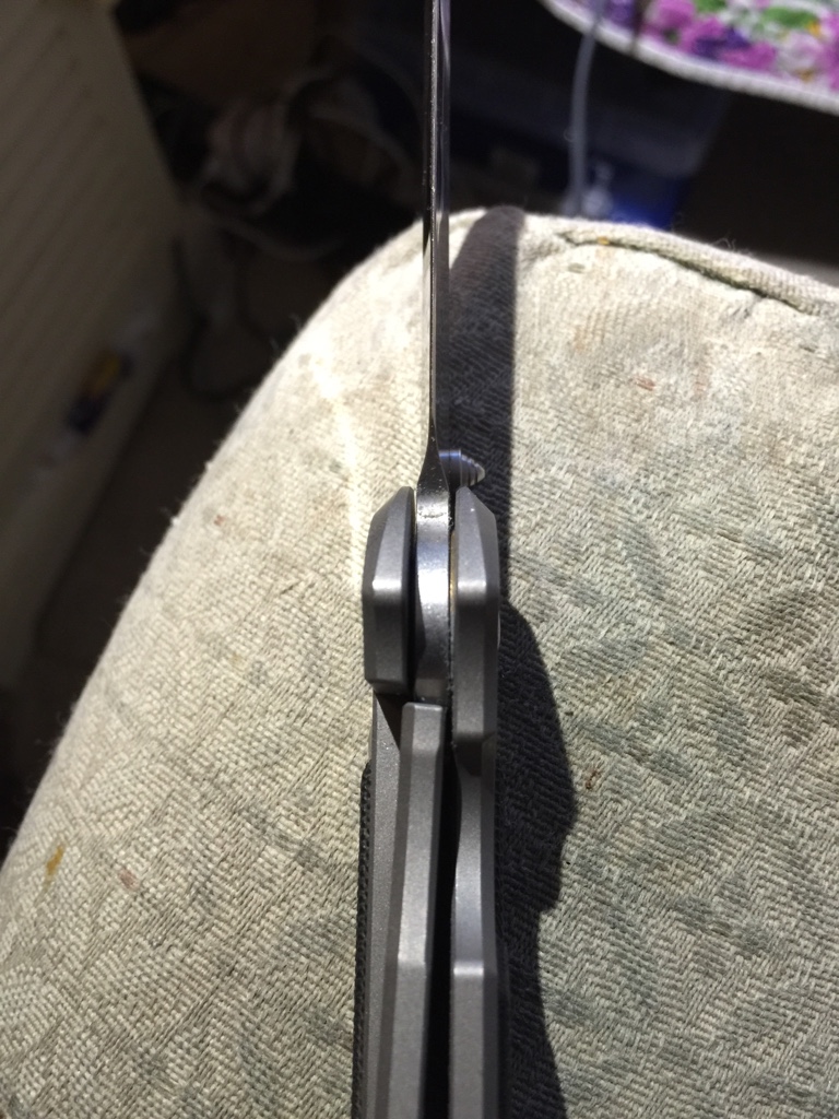

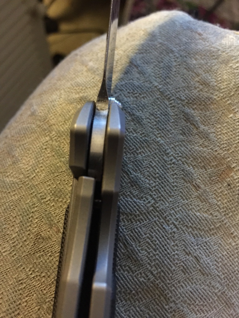

This is causing some lock stick. About 90% lock up. The knife is new to me and I've taken down a number of CRK knives but don't think this is something I can fix. Thinking of sending in for spa treatment and a fix. What say you?

Flick that knife open solidly (like you should be doing after a reassembly anyway), and watch it go back to it's happy place at 90%.
Putting a bind on the parts isn't fixing anything.

I 100% agree. It will adjust for a bit, but will go right back to where it wants to be.

The lock up percentage shouldn't bother you. If the lockbar isn't touching the other side, it is fine. The stickiness is a bit of an annoyance. I have seen most other framelock manufacturers say that you should not have ANY lubrication on the lockface, for fear of making lock stick worse.
IIRC, CRK recommends a touch of grease on the lockface during assembly. It's worth a try. Worst case scenario, it might have to go back to the mother ship for a tune up (possibly a reheat on the lockbar)
