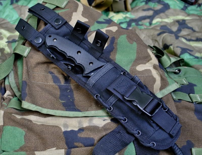

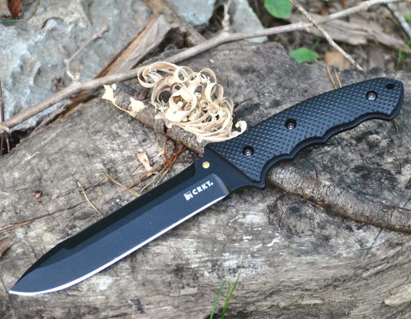

When I was looking over the CRK&T website the last time I was there I saw an interesting knife designed by Allen Elishewitz that caught my eye. In looking over the specs noticed some initials that quickly caught my eye too, SK5. With my having heard of Mr. Elishewitz's back ground in a Marine recon unit I was curious to see how the knife handled. I do have a preference for 6"- 6.5" blades and a major fondness for SK5 steel too from a few knives I have had in the past. The CRK&T website says that since Allen designed the knife "For Those Who Serve" they are calling the knife the F.T.W.S.

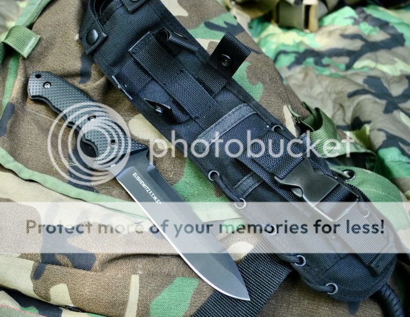

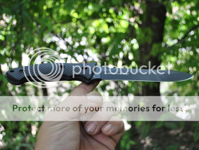

The knife comes in a tactical cordura sheath with a utility pouch on the front. It has a blade length of 6.3" (16cm), and an over-all of 11.6" (29cm). The steel is SK5 hardened to 57-58 HRC .

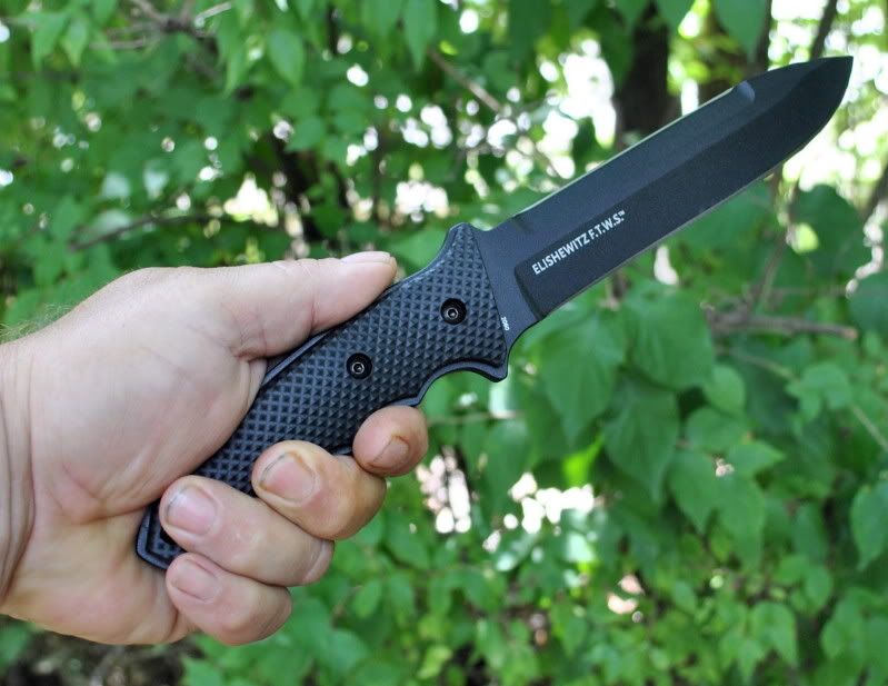

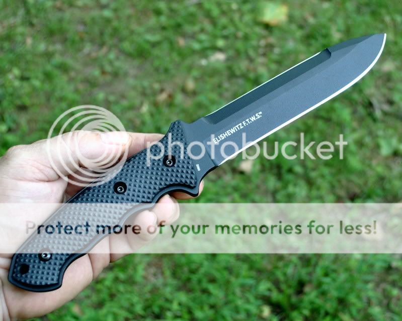

It has an integral guard and swell to protect the hand on plunge cuts. It also has finger grooves and heavily textured zytel handle scales for a good grip even in less than perfect conditions. It has a lanyard hole in the bird beak pommel.
The F.T.W.S. also has something seldom seen on factory made production knives, a taper ground tang which adds to the knife's excellent balance.The balance point is pretty much right where the blade meets the handle

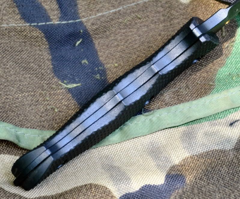

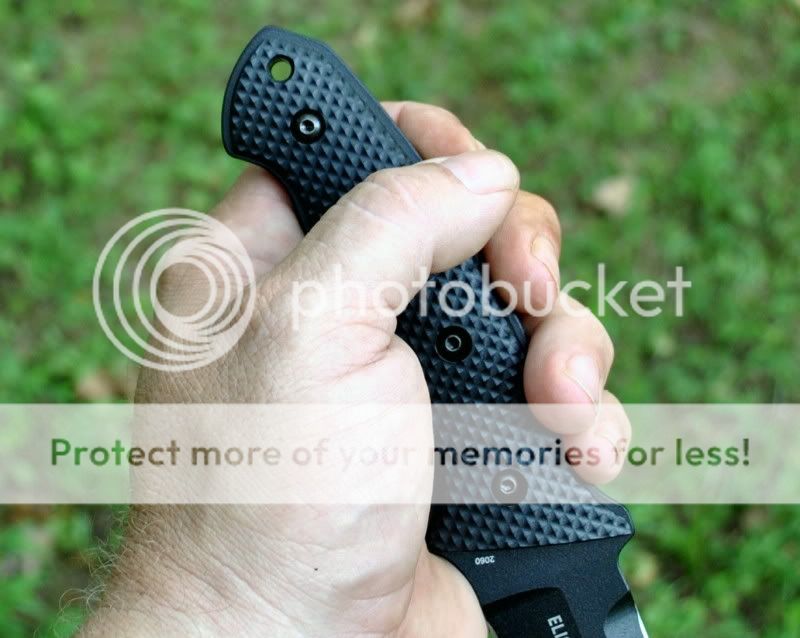

While personally I do tend to prefer the handle scales to be flush or close to flush with the tang...I do understand that for the purpose this knife was designed this could be a better option. In rough use any place on the edge of the handle can be struck or used to strike without much worry or damaging the scales. The handle itself does have a great shape, really comfortable in different grips.

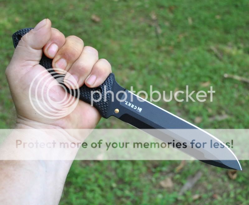

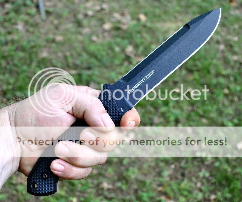

The shape of the handle lends itself well to a rearward grip for more chopping power in a knife not really designed to have a primary role as a chopper, and it is till comfortable on the palm in doing so.
It has a small, choil-like un-sharpened area immediately in front of the guard to hook an index finger around to aid in extrication.

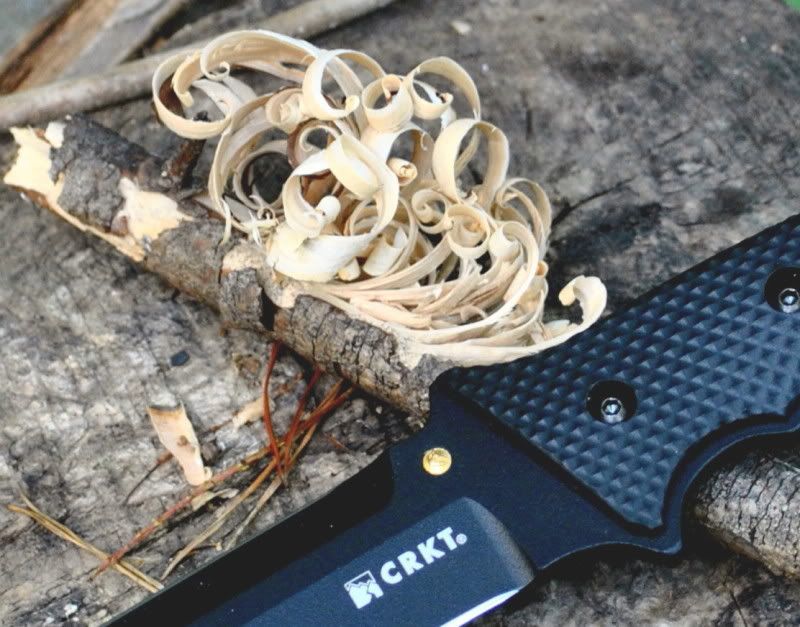

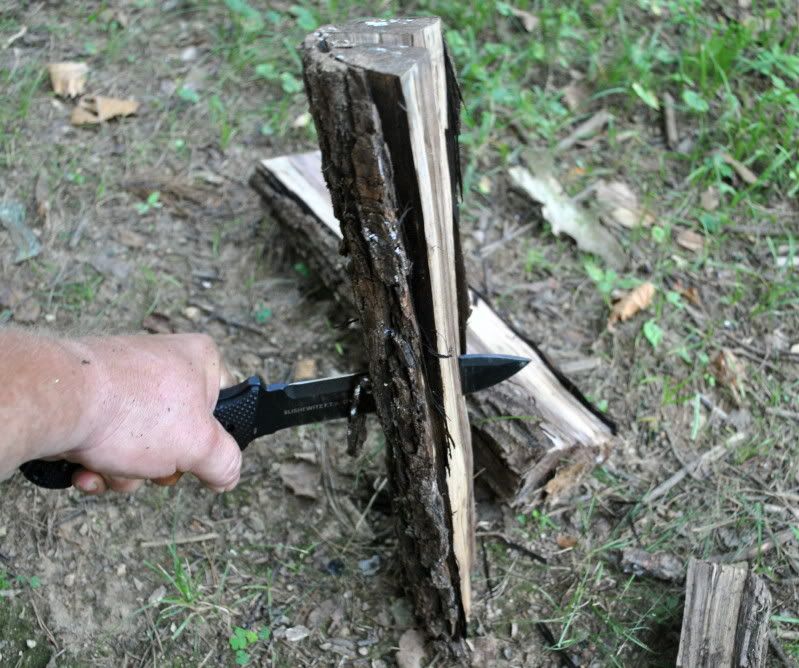

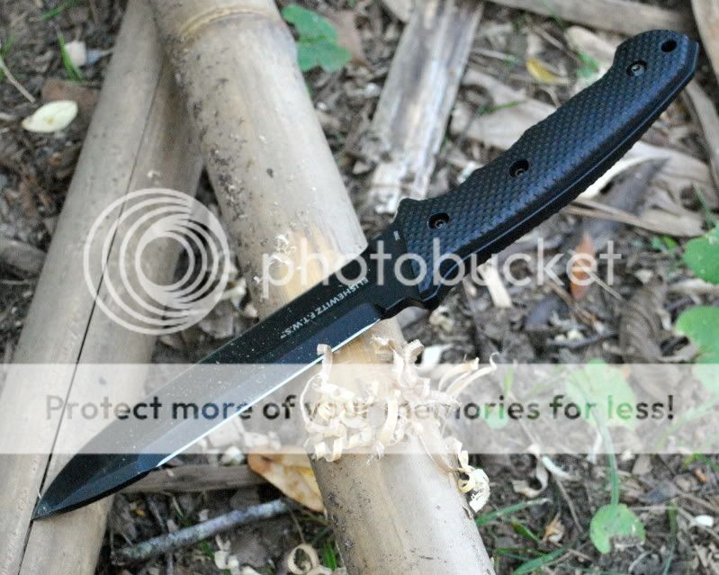

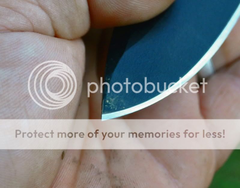

The primary edge is really sharp, and choking up on the handle using the small choil I was able to get some nice curls from some seasoned dead pine.

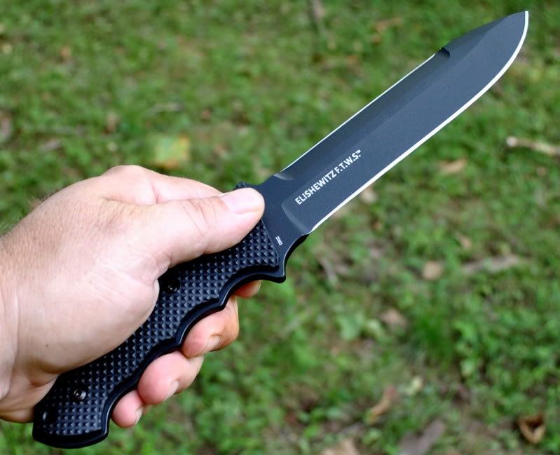

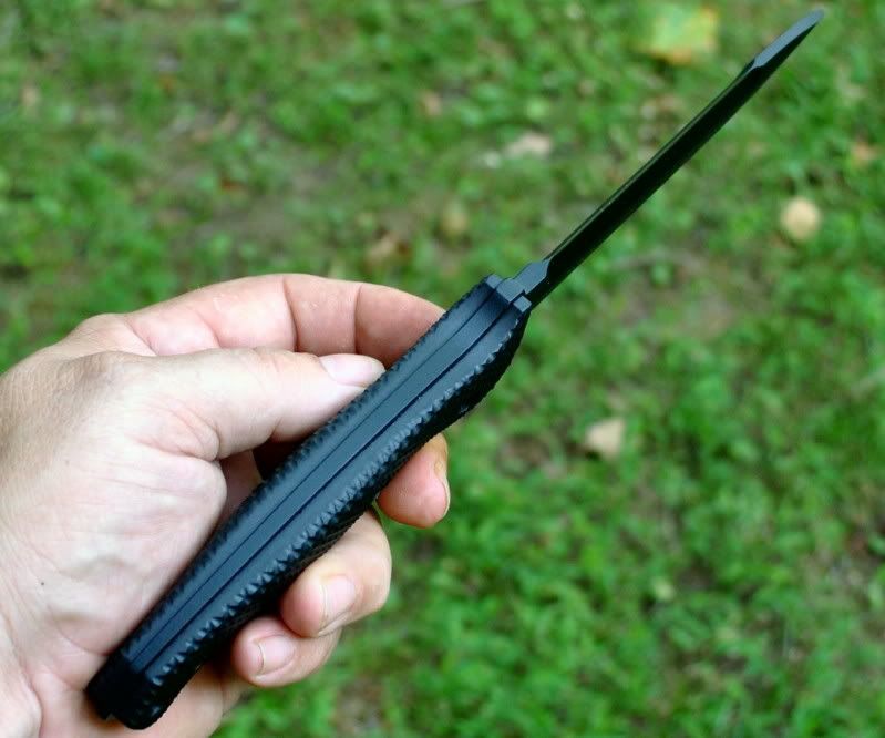

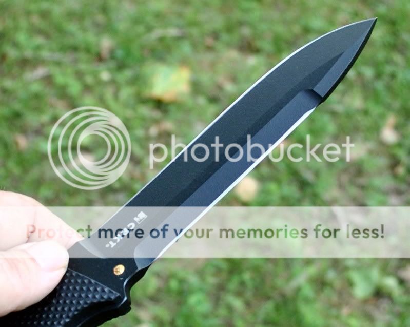

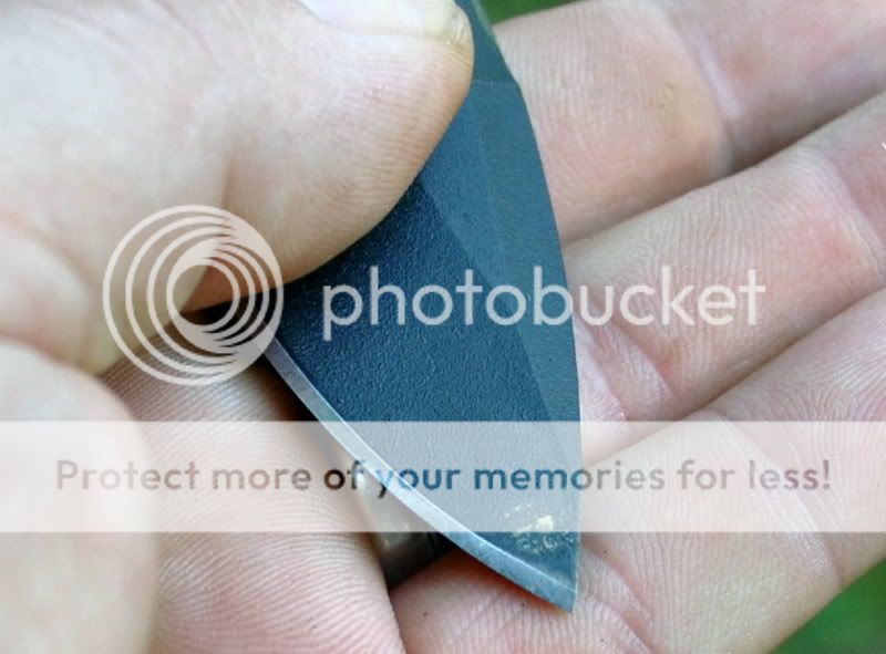

It isn't "double edged" in the traditional sense of a double edged knife but it does have a secondary edge on the spine. The secondary edge is more steeply ground than the primary edge for taking some rough use, but it is still very sharp and works well for scraping up tinder and sparking fire steels.

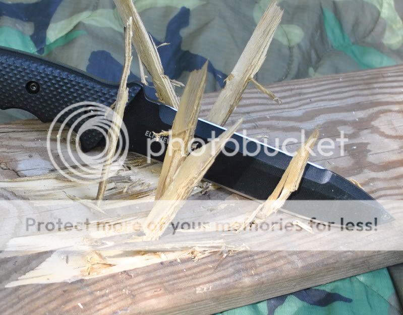

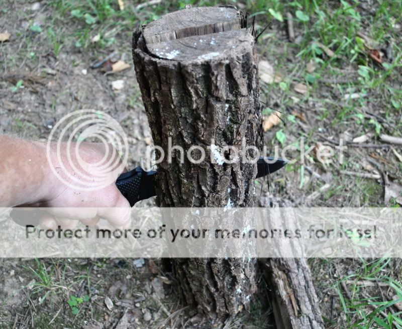

The secondary edge stops shy of the point to leave a strong durable tip for penetration. It suffered no ill effects at all from repeated stabbing into a hard, treated, yellow pine plank and prying out hunks of wood.
