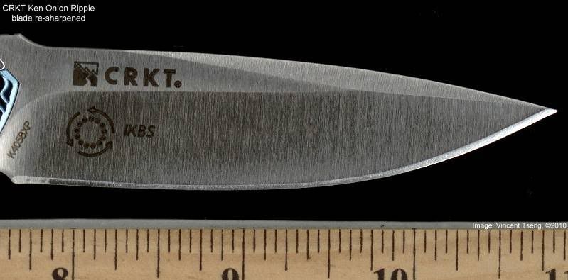

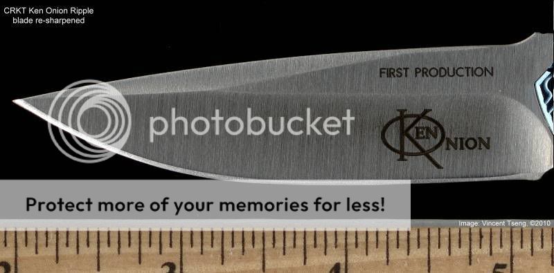

At an idle moment I examined the Ripple blade with a 30x illuminated microscope and was actually surprised to find the Ripple blade had a much higher polished edge than the Eros - but I eventually figured that the cutting edge angle of the Ripple just was not as acute as the Eros.
So I set about re-sharpening the Ripple - and since I like the looks of the Ripple and did not want to mar the finish - I taped up the face of the blade and the scales adjacent to the blade exposing only about 1/8" to the edge - then used my EZE-lap fine diamond hone to work s more acute/shallower angle to the bevel -
But taking the opportunity to roll away the discrete corner between the blade face and the bevel - so it becomes a sort of "zero bevel" - without taking anything drastic/much off the actual face of the blade.
This rolling motion puts a convexed bevel on the blade which helps in cutting through things as well as giving better support to the actual cutting edge itself. (see my earlier attempt from almost 6 years ago - Convexed Edge )
I was pretty pleased with the result - the blade does cut distinctly better than before - still not as good as the Eros - but I really do think it is the shallower bevel combined with the continuous cutting curve that makes it for the Eros -
anyway here are some pics of the resultant edge - both sides:

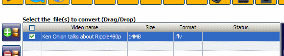

Use the Add video button:
and find the video and add it to the list:
toward the bottom left:

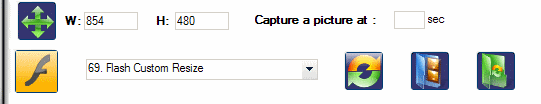

one can manually enter the (custom) size of the video -
in this case I have typed in 854x480 (for 480p)
360p= 640x360
240p= 426x240
