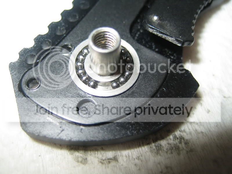

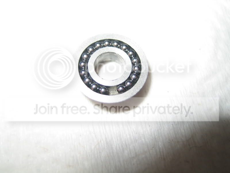

heres what i have cleand it and now waiting for the parts
its obvious whats missing
I always find CRKT customer service is very responsive.......Good to hear that you found the solution.
gotta get a good lube to put in there as i cleaned it out,,all i have is some rem oil, think that will work
sorry for hijacking this thread. I really should have started my own before i added the pics,,but in the mean time BUMP for my question about the oil/lube
