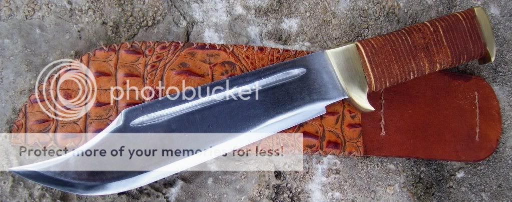

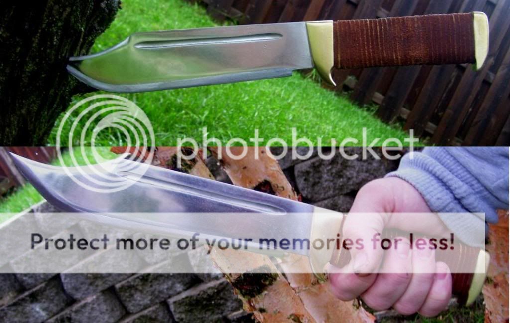

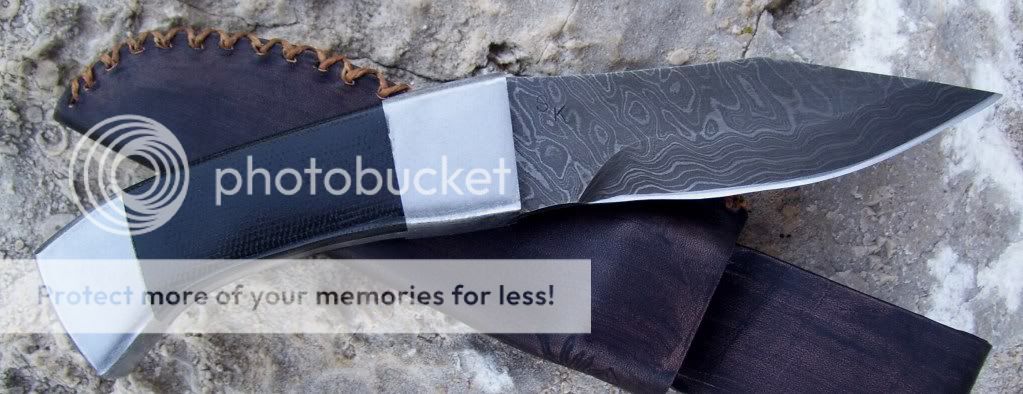

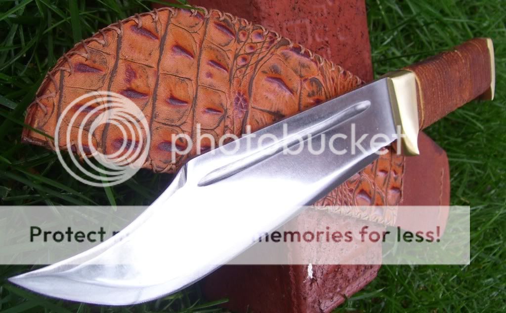

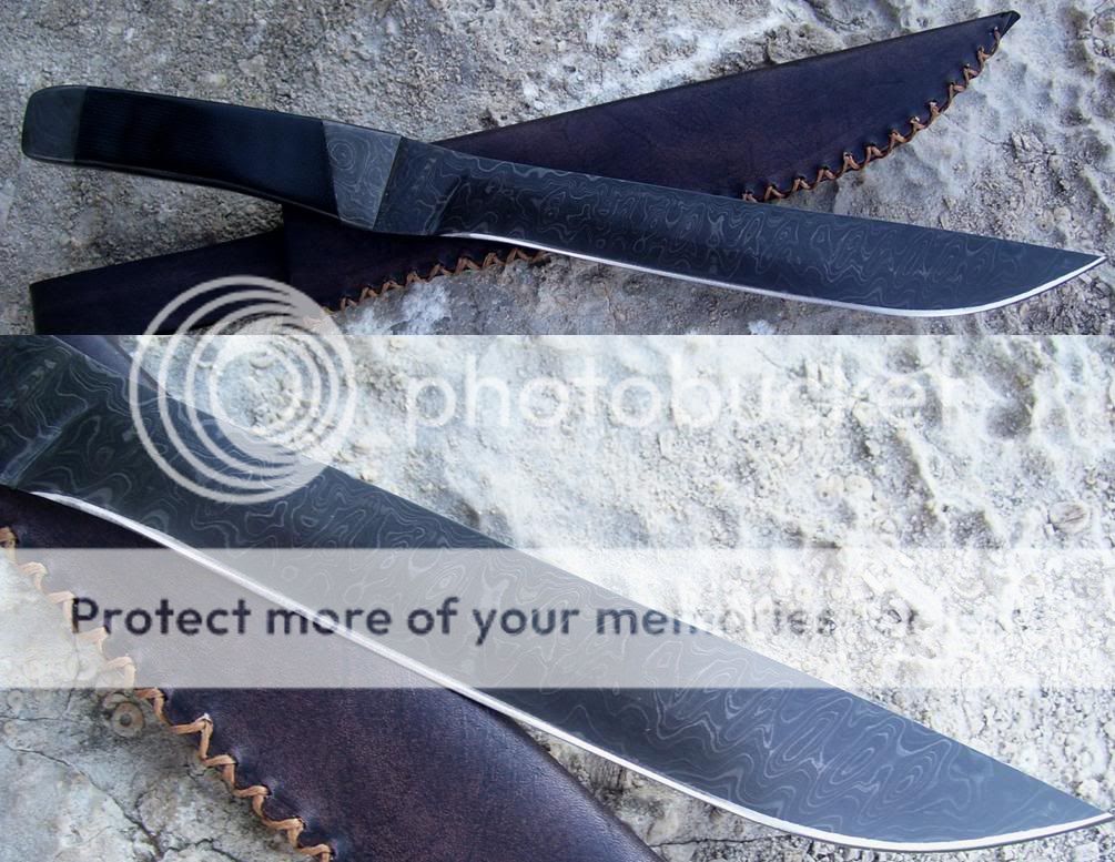

Hi friends. Have a few custom orders I did that I’d like to show. Hope you like them.
Shop Details – Crocodile Hunter Knife:
5160 Spring Steel cut out and Normalized @ 1500 degrees until non magnetic, three times, to remove stresses and align crystals. Heat Hardened until blade became nonmagnetic, then quenched in 125 degree quality oil. Tempered the blade to a straw hardness @ 425 degrees for 1 hour, letting it air cool and repeating once more. Blade was file tested and is shown to be very hard.

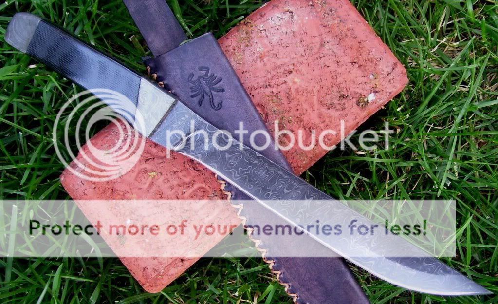

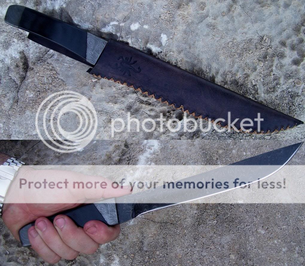

Shop Details for the Damascus Knives:
Material = (4) layers 5160, (3) layers 203E, (3) layers 52100, (3) layers 15N20 folded 5 times for 416 damascus layers. 5160 Spring Steel cut out and Normalized @ 1500 degrees until non magnetic, then quenched in quality oil. Tempered the blade @ 350 degrees for 1 hour, letting it air cool and repeating once more. Blade was file tested and is shown to be very hard. Got the Damascus from Alabama Damascus.
The Crocodile Hunter – Influenced by Crocodile Dundee
Released a Youtube Video on this one last night. Thought I'd attach it. It's got some neat clips of the outback and a demonstration of the knife.
http://www.youtube.com/watch?v=jzQGciBgzDg
Total Length = 15”
Blade Length = 9 1/8”
Blade Width = 2 “
Blade Thickness = 3/16”
Handle Length = 5 5/8”
Handle Width = 1 ¼”
Handle: Leather Wrap
Weight = 1 lb 6 oz
Hand stitched Leather Sheath with Imitation Gator Hide

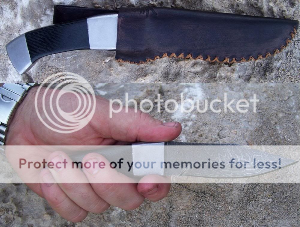

Damascus Scorpion Bushcraft Knife
Total Length = 13 3/8 ”
Blade Length = 9 ”
Blade Width = 1 “
Handle Length = 4 3/8”
Handle Width = ½ “
Handle: Black Micarta
Weight = 1 lb 2 oz
Hand stitched Black Leather Sheath
Damascus Bear Claw
Total Length = 8 “
Blade Length = 4 3/16 ”
Blade Width = 1 “
Handle Length = 3 13/16”
Handle Width = 5/8 “
Weight = 13 ½ oz
