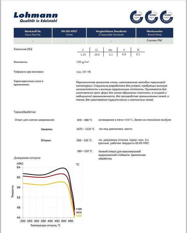

Anyone know where I can find a knife steel chart that shows the composition of elements for Cromax PM steel?
Thanks, birdave.
I'm interested also. Shirogorov has "stumped the band" so far with Cromax on their low end Quantum flipper.
While we are here, any idea what wood they are using for the inlays and whether it's stabilized? Another mystery so far.
I dropped Shirogorov an email asking both questions, and got crickets.
I asked on IG and saw other comments asking with no answers either. Seems they’re terrible about it, I even asked Recon1 with no answer. So I bought one anyway!
I did read a comment somewhere that Cromax was a beefed up Elmax so to speak. As far as the wood inlays, they sure look and feel just like walnut to me and I believe they are stabilized as mine appeared pretty dry when I received the knife but it only took a small amount of oil to bring them back, the oil never really soaked in, just coated the outside surface and took the dry look away (I used lemon wood furniture oil)
Not even close to Elmax
C 1,7% V 3%
