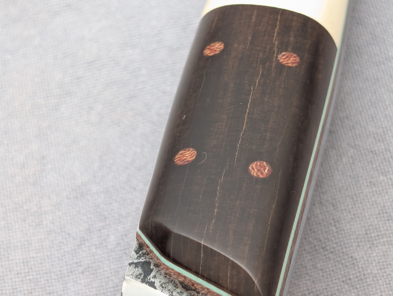

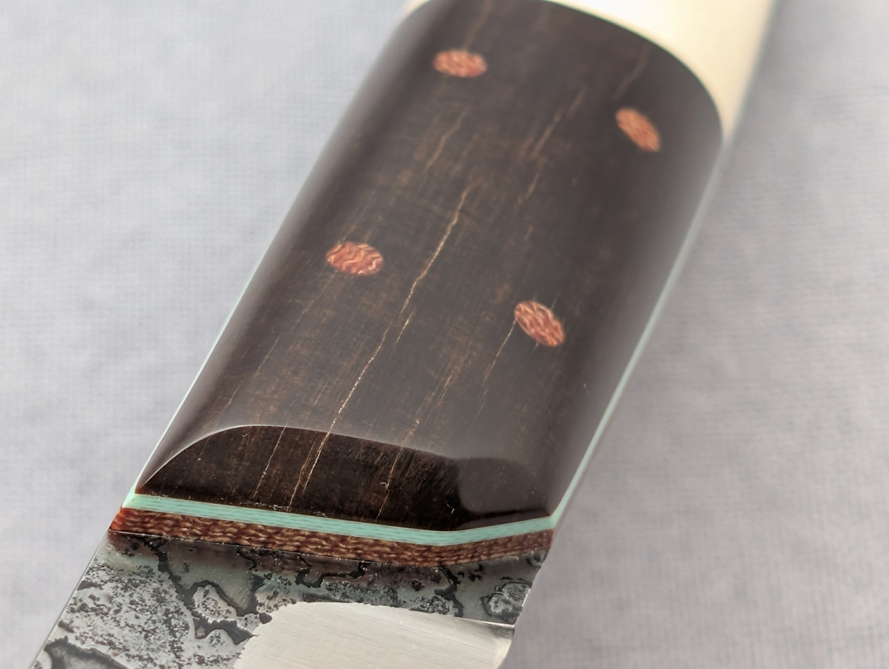

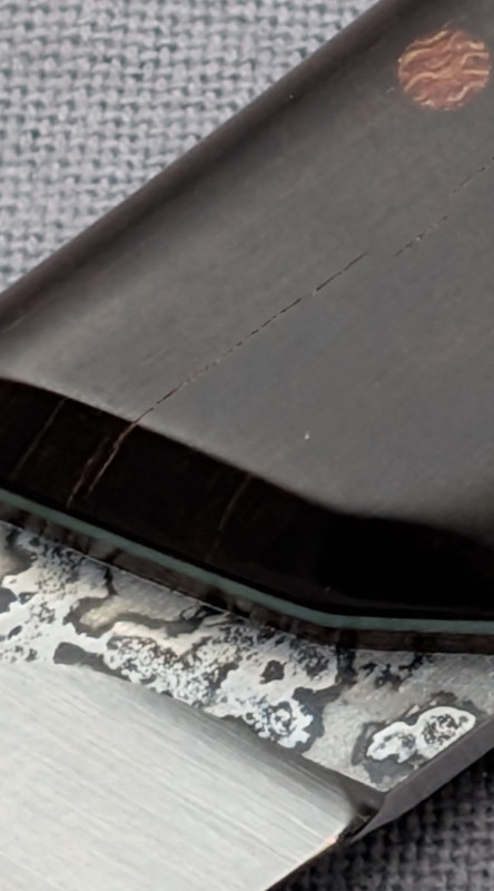

Is it normal for crosscut paper micarta to crack? Just got this one in and really don't want to send it back..... No more available. Is it more of an aesthetic or something that would continue to get worse?
I'm guessing it was overheated when being finished but I've never had a knife with it before.
Mods, please move if I posted in the wrong forum.
I never had crosscut paper, but I know many makers won't use paper micarta as it's weaker.
If you really love it, and can live with it, it's pretty easy to soak "crazy glue" into the cracks, then gently sand down. You will have to do many sessions. And refinish it overall.
That was what I was thinking but not sure I want to put that much work into it. I'll have to think about it. Reached out to the maker so I'll see what their response is first.
I agree..... I'd only do it if you had Love/history with it.
I tried to use some richlite in that orientation (cross cut) and it developed cracks like that before the knife was all the way finished.
Looks like unstabilized wood that has started splitting. Possibly shipped from a different part of the country that has a different humidity??
I had a couple of older ivory paper micarta blocks split down the middle into scales after sitting in my uninsulated/unheated shop for 15 years. It can happen. Temp/humidity changes, pressure changes, like airplane cargo holds, etc can do weird stuff.
Another vote for wood, not micarta. Paper micarta really doesn't have any grain like that. If you do see any grain in paper micarta, it's very thin and very linear.
This does not look like wood to me at all. It looks to me like delaminating crosscut Micarta of some vintage variety.
I was thinking exactly what DM says. It's hard to be sure on my phone if wood vs micarta from the pics, but the surface is has such smooth uniformity it seems like a polymer, and the consistent white in the cracks seems like adhesive remnant (you wouldn't expect to see that in every crack in unstabilized wood), and the coloration is consistent with vintage micarta. Although the irregular rather than linear cracks are more consistent with wood . . . but then again, in paper micarta the layers are less pronounced . . .
Well either way, it looks pretty tricky to fix nicely - it would take some very low-viscosity (thin) and slower-cure super glue to actually penetrate into the cracks past the surface, and then require sanding and rough-buffing the entire bolsters. But those are some nice bolsters if you can make the effort! Or you could ask the maker to take that on.
If it is vintage paper micarta, it might eventually get worse, but not as quickly as unstabilized wood in that condition would do since as a uniform polymer it's less sensitive to temp and humidity changes than wood. And that stuff has to be from at least the 60s or maybe earlier, so it's been holding up pretty well and should probably continue to do so for decades yet.
