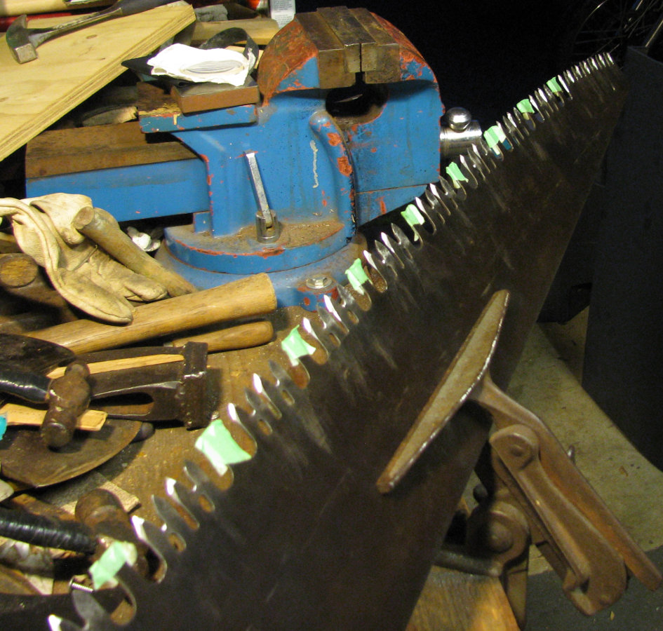

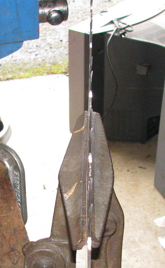

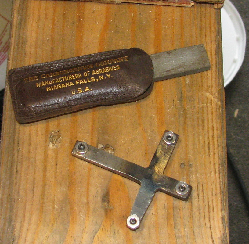

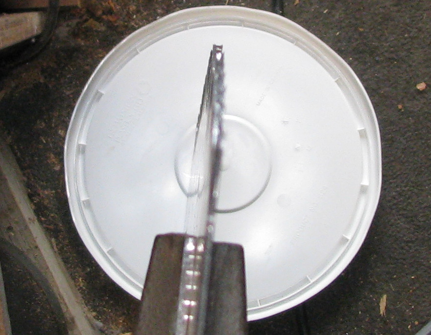

Finished filing tonight. Got quite the pile of filings. The little stone at the top is for removing the burr.
78 points jointed and shaped. I still have to set the cutters.

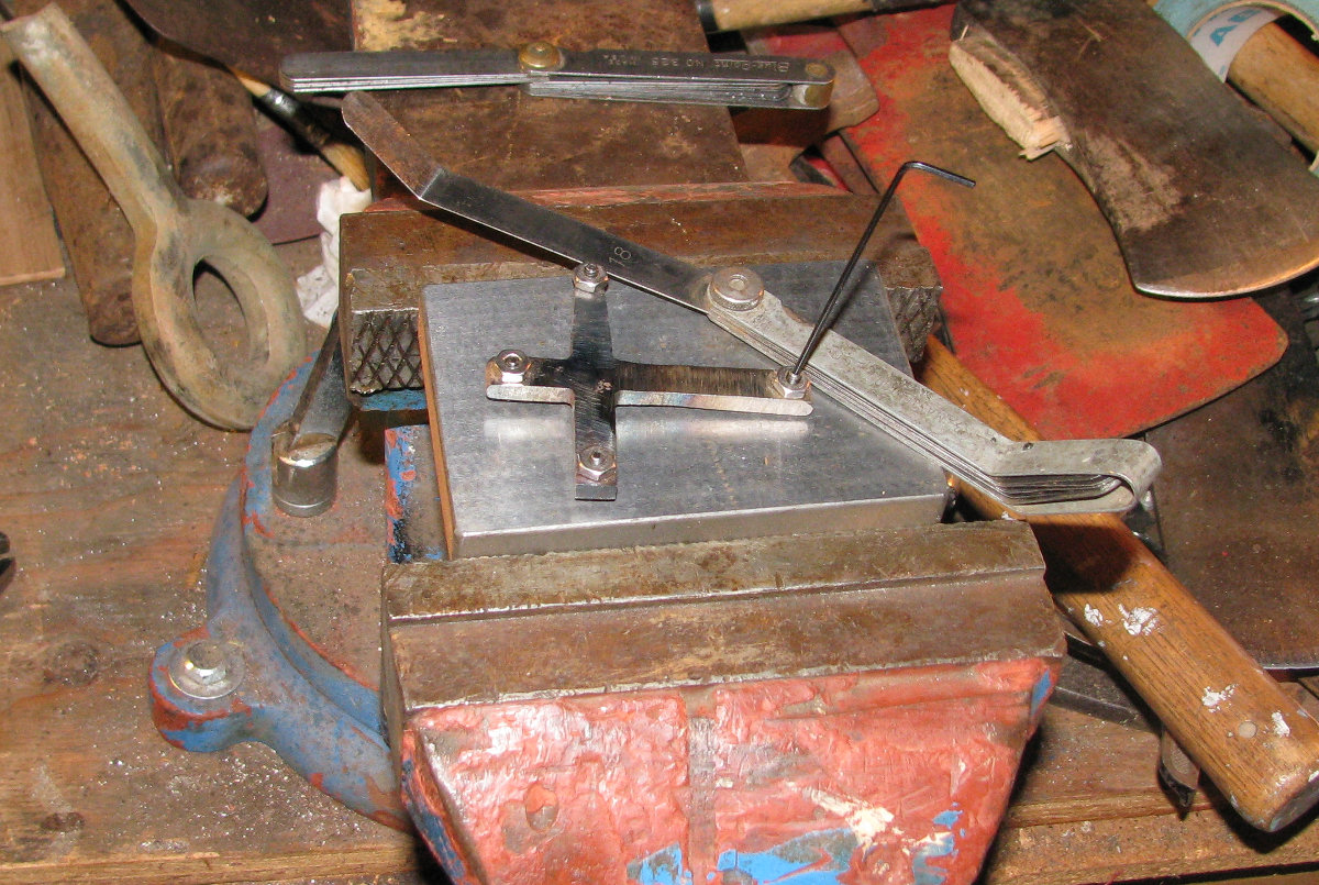

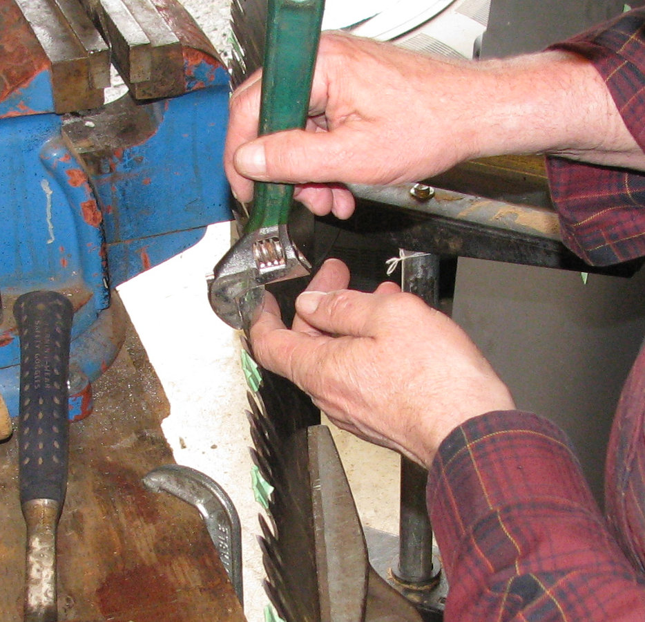

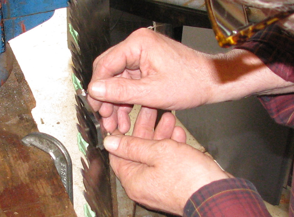

Calibrating my homemade spider on a true machined surface. For this flat ground saw I'm taking the set up to .018".
My spider is made from a scrap of 1085 agricultural steel that I annealed and cut to shape and tapped. It's fully adjustable with set screws on all 4 points. I do have a nice Simonds 342 file and raker gauge. That's a critical piece of equipment.

the closest i'v come to a saw vice is a 45 cut into a log for touching up teeth. believe me, a MOUNTED vice would be nice. you guys would scream if you saw how i file my saws. you guys have all your fancy jointers and CC saw tools... im over here like HAMMER MAKE RAKER GOOD
