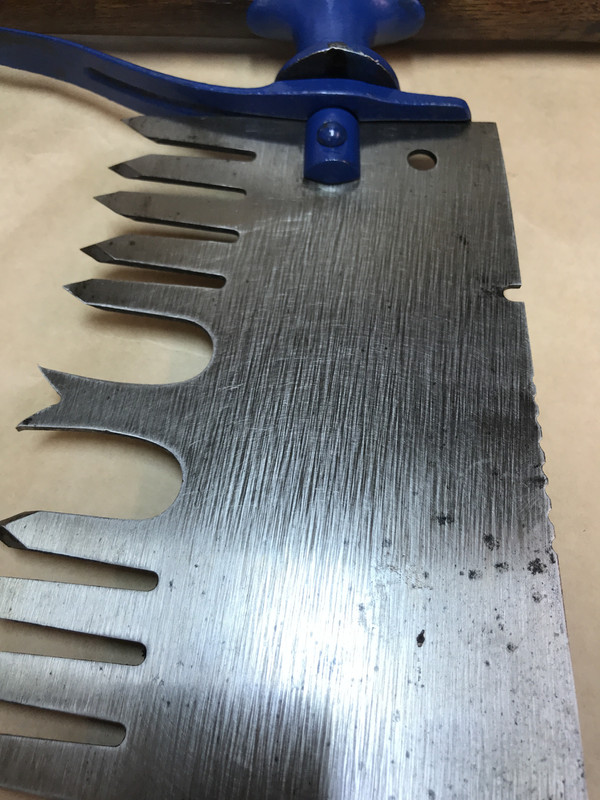

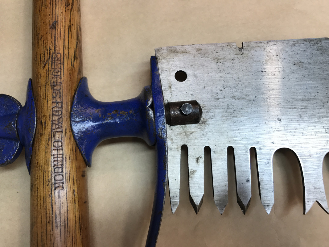

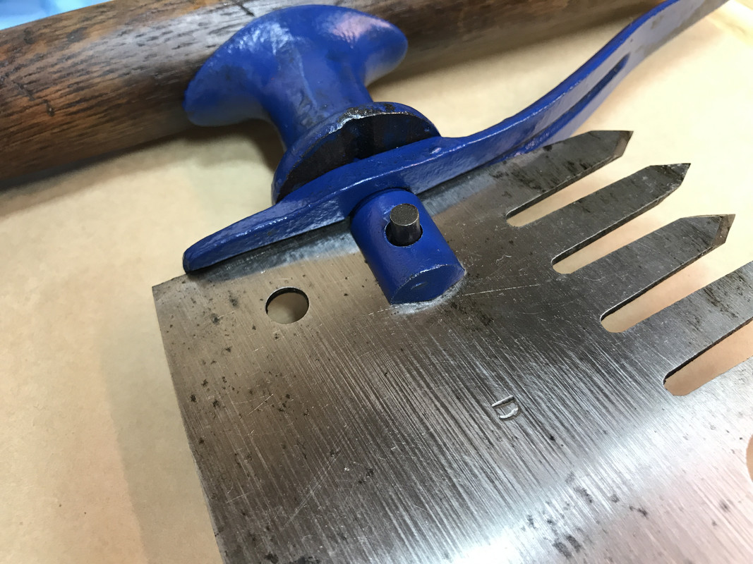

So I removed what I understand to be the factory guard from this Simonds 520 for the first time in 30+ years.
I had not previously removed it to look at the blade prior to buying it.
It needs the grime cleaned off but appears to be in pristine condition.
Back side has what looks like a “D” stamped next to the handle?
Hard to show how crisp the tips are, even across the middle. Makes me think it hasn’t seen much any use and to my layman’s eye, doesn’t look like it has ever been sharpened.
Maybe NOS?

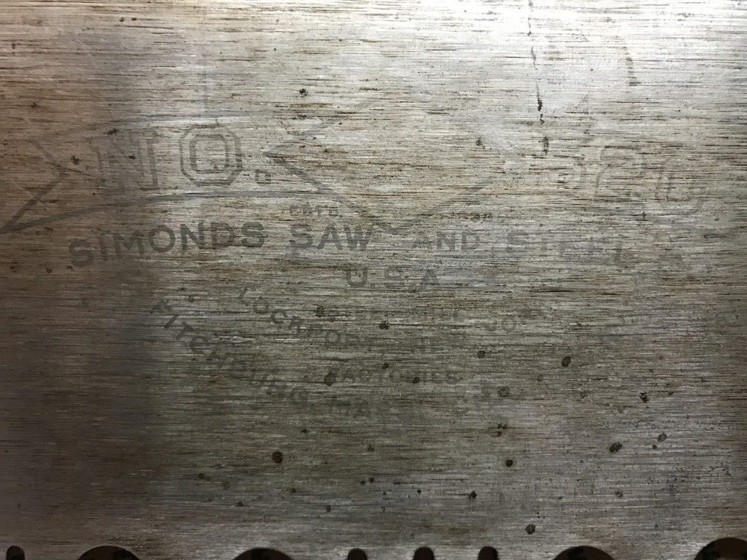

The handles have Royal Chinook stamps.
I don’t know anything about the 520 or the Simonds line for that matter. Any info would be appreciated I have no idea how old it is even?

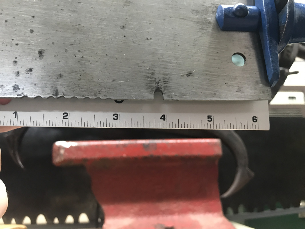

Also can anyone tell me what these little knurled bumps are near the string grooves?
Thanks!

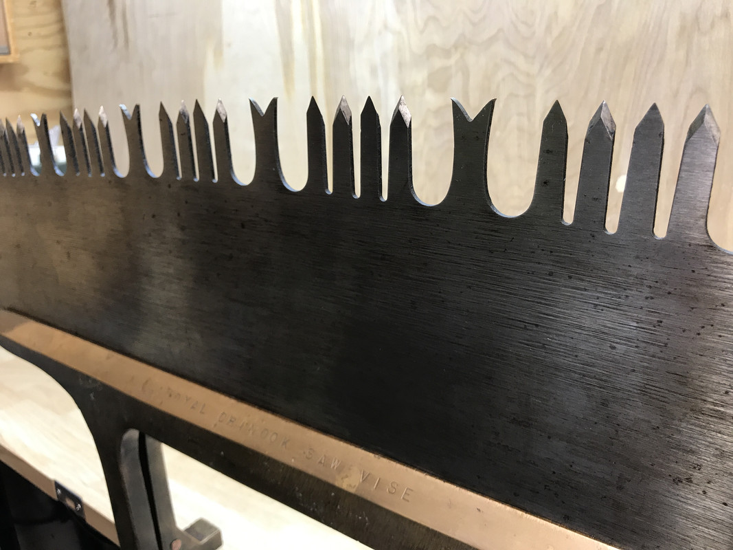

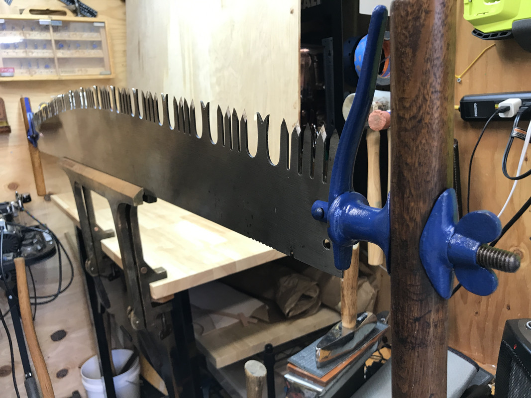

Ok fellas I need your expertise I've never sharpened a handsaw but need to purchase the correct/optimum file to do so. Already cut one oak up into logs with it so it's dulled a bit and needs to be touched up.
https://www.amazon.com/BAHCO-PC-24-...rds=bahco+hand+saw&qid=1560567392&s=hi&sr=1-6
Another tree fell yesterday (lightning I think). Gotta process that now too
Also do you use wax on your hand saws? If so how many strokes until you reapply the wax? Or do you just go by when you can feel it all come off?
And yes I know the saw is too short for most trees but the price goes WAY up for bigger saws if you order new so I'll have to wait to find something used before I upgrade to something bigger.

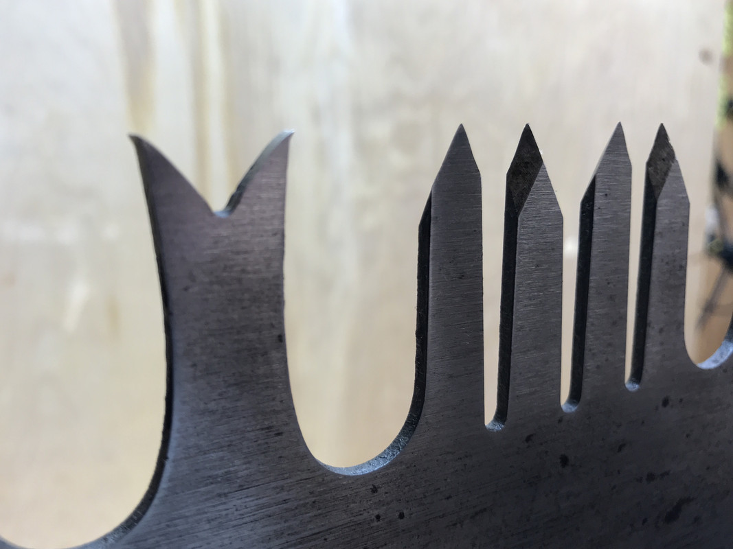

That type of saw typically has impulse hardened teeth. They usually aren't re-sharpened. A friend does resharpen them with a dremel. He grinds only a tiny bit off the little tip facet seen in the image below. I haven't sharpened any myself but I've used his saws and they cut like new.
That makes sense!I wonder if they were filed on there for purchase with gloved hands on the spine. I'm sorry i can't recall who, but there saw maestro here that uses a hand on the spine when cutting in competitions. I apologise to whomever it is for not remembering. I'm thinking this might have been a competition saw in its previous life. It would explain the condition, the skill with which it was filed, and modifications.
