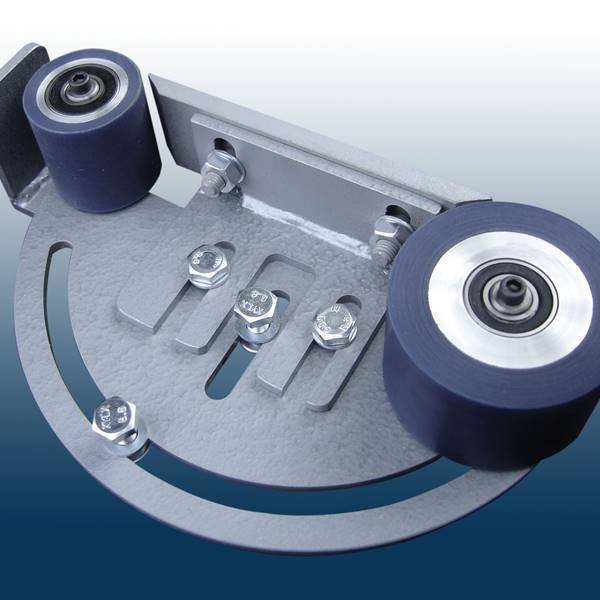

After using years the carroussel I posted above, I'm finishing the design of this new one, I removed one wheel because I didn't use much the short segment of the triangle, I mostly use the platen, the other side with no platten for handles and then the rubber wheel, so this new one is the synthesis of what I use.
The actual platten is screwed to its base, so if you need to re surface it, you just take a spare and keep going. I surface them both sides.
